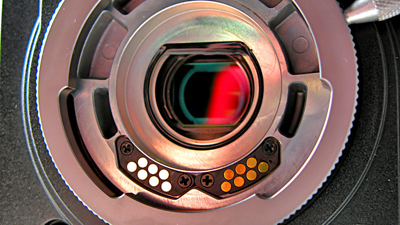

William, have you looked closely at the inside of the lens mount on the camera to make sure you don't have any foreign objects floating around the mount and the protective glass?
Get a flashlight - and a film-loupe or other magnifying glass - and even look *behind* that square-ish protective glass on the lens mount. Although unlikely it's quite possible that something got inside behind this protector during manufacturing and is moving around.
If you don't find anything visible in our outside the mount definitely take it in for service and let us know the result.
