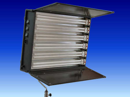

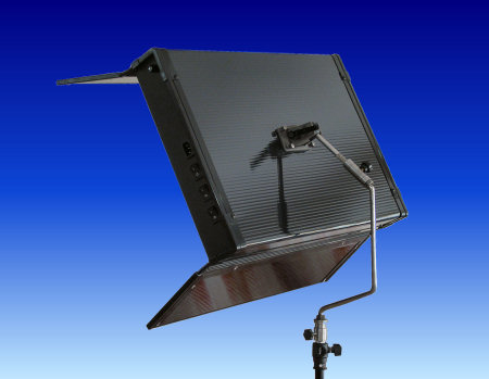

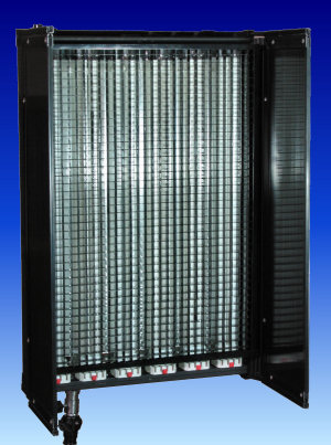

We'll finally have eggcrates this time too for all the old as well as the new flo fixtures. I'm including three shots of one of the new fixtures you haven't seen before--the CL-655P plastic portable lightweight model including a back view with the special lollipop and lollipop to stand adapter. This allows you to keep the center of gravity over the stand where it belongs. Also including a picture of an early model of one of our cases too--known as "CL-CCL2."
Minimal lighting kit; filmgear lights?-cl655peggcratesbluebkgndcm.jpg   Minimal lighting kit; filmgear lights?-cl655pbackbluebakgndcm.jpg
