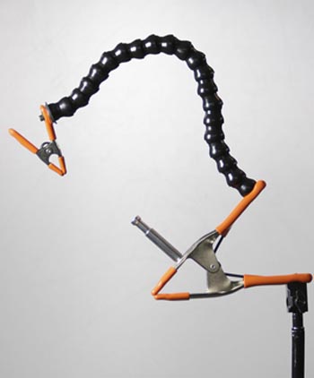

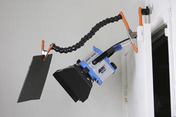

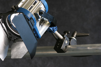

Here are some that I use the most.
still learning/need advice re best clamps, how to make(buy?) cukaloris?-grip-superclamp-arri300.jpg   still learning/need advice re best clamps, how to make(buy?) cukaloris?-grip-custom-clamp2.jpg
still learning/need advice re best clamps, how to make(buy?) cukaloris?-grip-custom-clamp1.jpg
EFPLighting.com - Lighting Workshops and Online EFP/ENG Lighting Tutorials by Nino Giannotti
