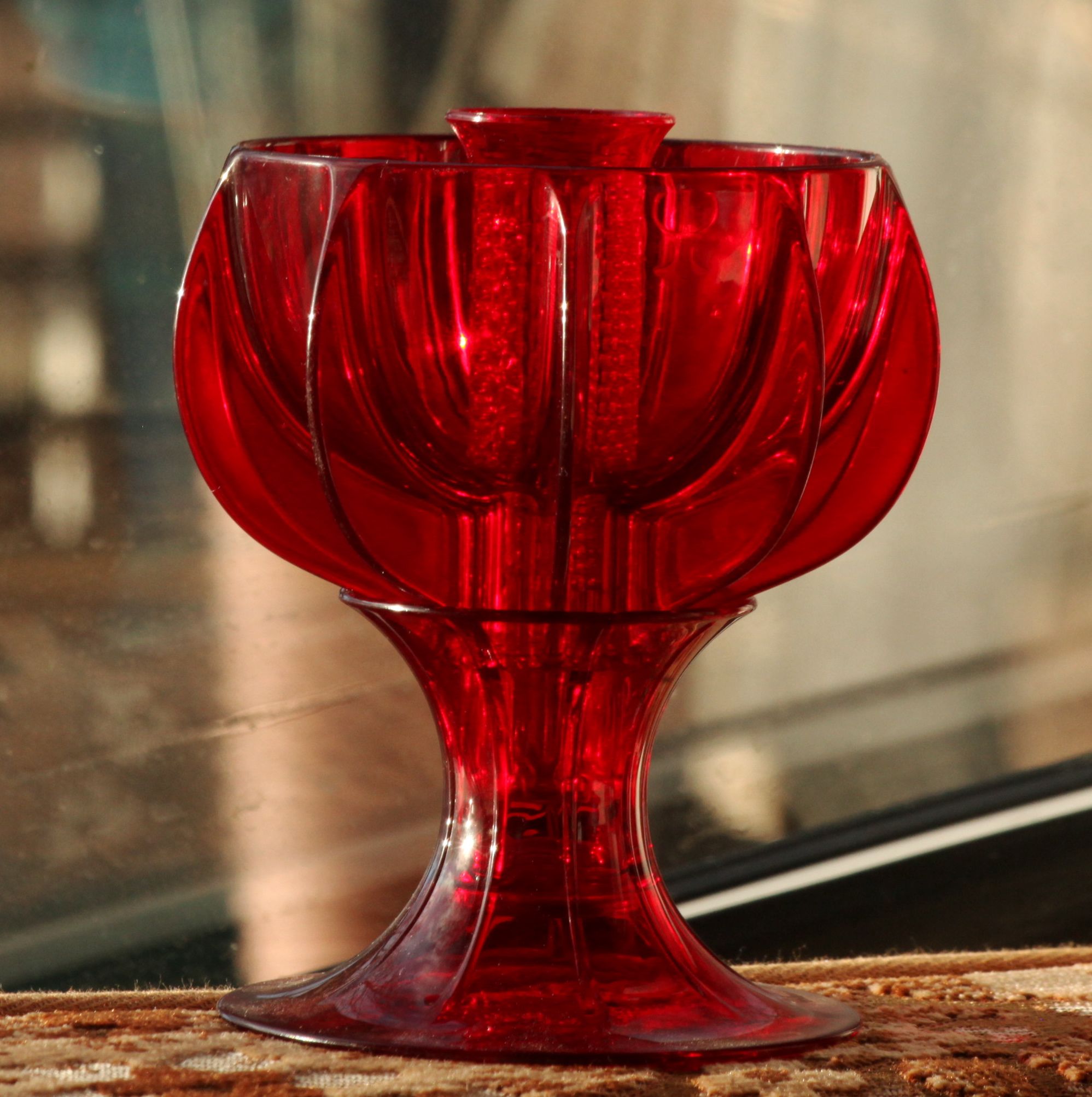

I've got a product shoot to do for a wine aerator.
This gadget sits on top of a wine glass. You pour wine through it and it aerates it - in 8 seconds, instead of more like 40 minutes that it would take to breath naturally.
Here's a photo of it, sitting on its stand. The bowl part lifts off and you sit it on top of a wine glass or decanter.
I want to film it from all angles and have it spinning too.
There are streams of wine that emanate from the underside of the aerator and flow down the inside of the glass.
The idea is to film the wine being poured into it too, from a bottle.
As you can probably see, it's plastic.
I'd like to make it, the glass and the bottle sparkle as much as possible.
Against a white background.
I've never done a shoot like this before so if anyone has any tips I'd be really grateful to have them.
Many thanks.
BTW They come in different colours. And the core in the middle slides up and down and can be removed. I am planning to use coloured cores with a clear plastic bowl (the bowl with fins on that you can see in the photo).

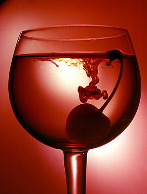

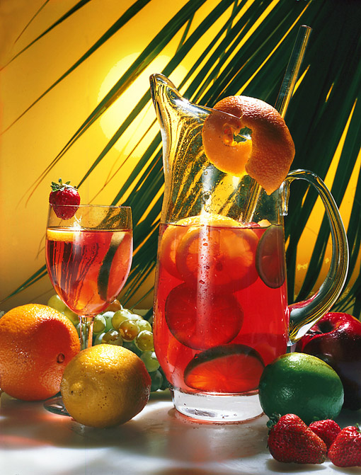

Speaking as an old food photographer, there's one good rule when you are dealing with glassware: you light the area, not the glassware; the glassware gets it's character from the highlights and darks reflected in it. Tall, narrow strip lights put highlights where you want them, or light foamcore pieces and let them be reflected in the glass. Bubbles are best lit from behind or below as they diffract the light and give highlights and shadows that give them form, if you light them directly you just get glare.... Large, indirect light panels reflected into or behind/below are most effective (indirect: light the panel, let it show beside, behind, below the glass, if you see what I'm getting at) /Battle Vaughan, who misses his 4x5 view camera more than any other tool he worked with, even video....

Brilliant. That makes so much sense and I was going to do it all wrong. Encouraged by previous advice that I had received about lighting this situation.

PS: couple examples of what I was talking about...
product shoot - wine aerator, glasses, bottle pouring-tropical.jpg   product shoot - wine aerator, glasses, bottle pouring-secret-ingredient.jpg
