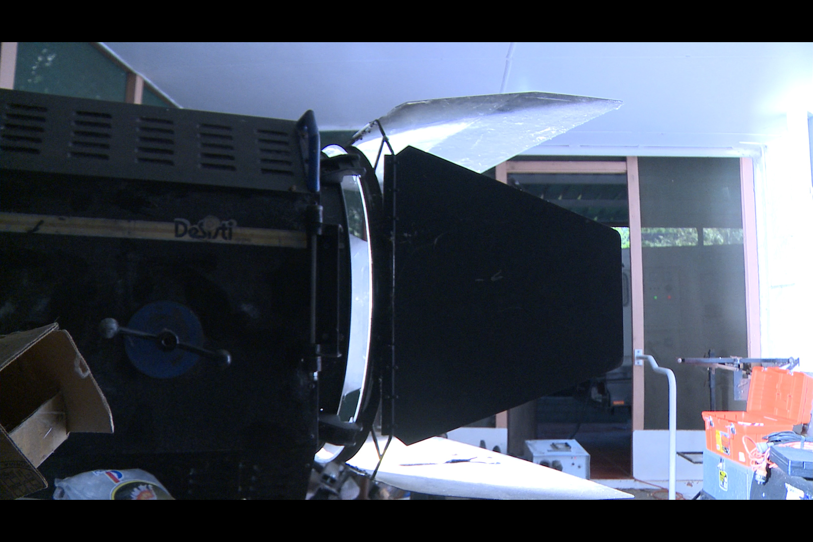

Here's a happysnap of the 1.2K that wasn't.
