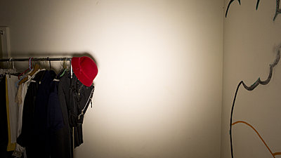

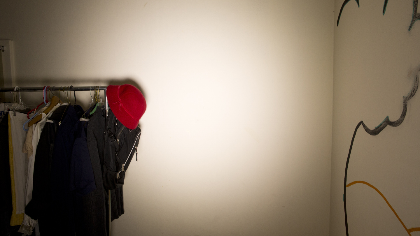

I just picked these up from eBay. Plugged them in and immediately noticed that the spot LEDs dip to magenta and the flood LEDs spike green. Do brand new perfectly functioning models do this?
I understand that LED are going to shift a little one way or another and I would be okay with it if the shift was consistent from spot to flood. But for it to change during focusing seems like a big problem, especially at this price point.
I realize I could go Kino and get better lumen/watt and CRI for the money but I wanted to go with the Litepanels so I can eventually add a battery system for ultimate portability easy setup.
What do y'all think?
Litepanels bi-focus shifts green/magenta while focusing-lp-spot.jpg   Litepanels bi-focus shifts green/magenta while focusing-lp-flood.jpg

I've noticed this with Litepanels and with the Ikan IB1500 panel I just reviewed. The daylight LED's have a mild, manageable green spike. The tungsten LED's have a horrible green spike.
See the horribleness here:
Testing the Ikan ID1500 & IB1500 LED Panels | Tall Tale Pictures . Blog
