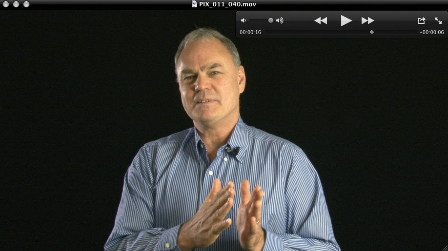

If that's the case, then I'd certainly echo Bill's suggestion of the 18" Diva Ring Light, I use one as both key and fill, with a Chinese 700 LED panel for a bit of a back/side light, and for a cheap and simple combo, it really works a charm.
Being cool-running lights, they also don't get your interviewees working up a sweat.
