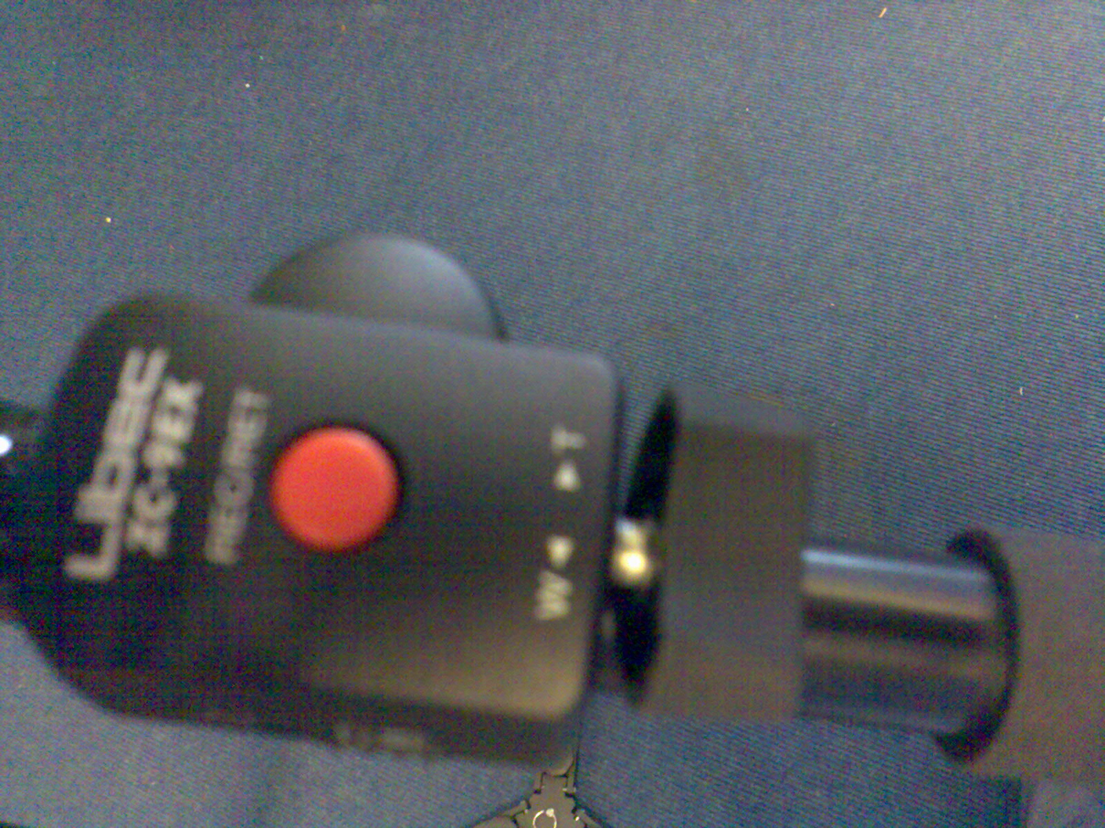

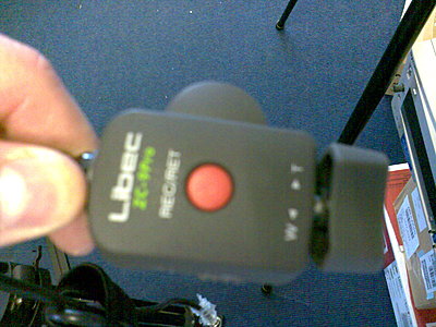

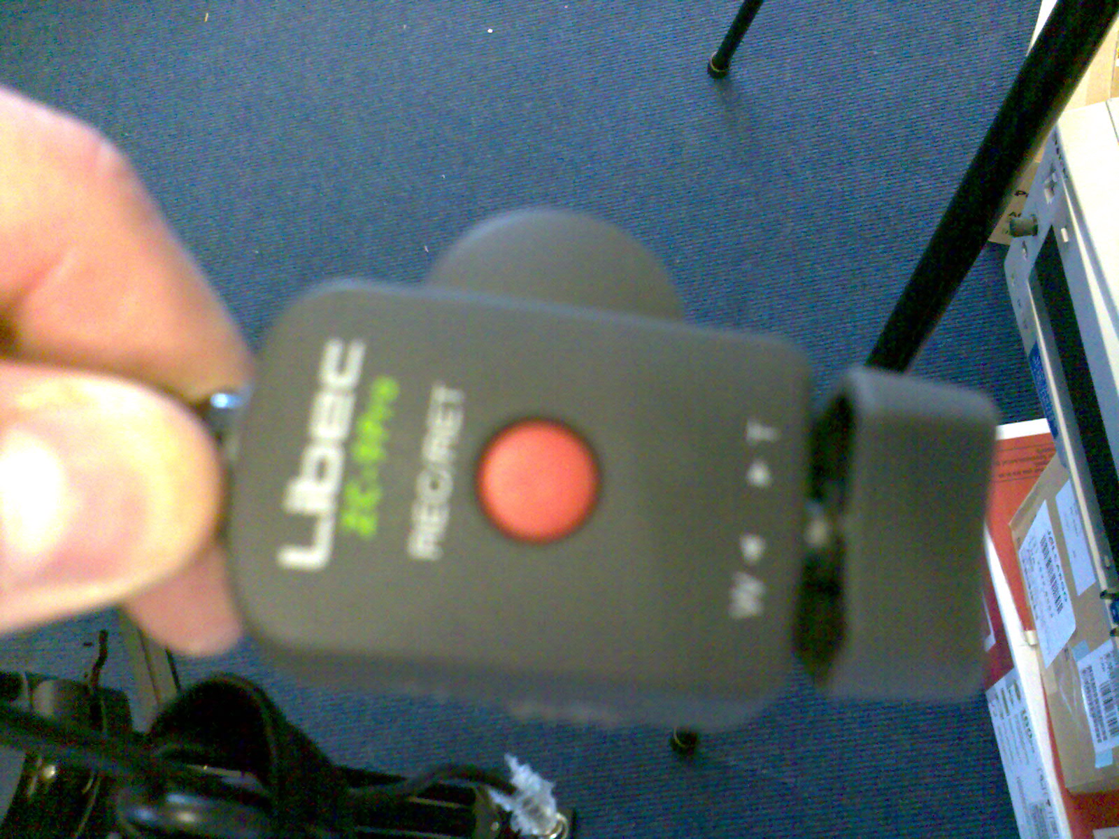

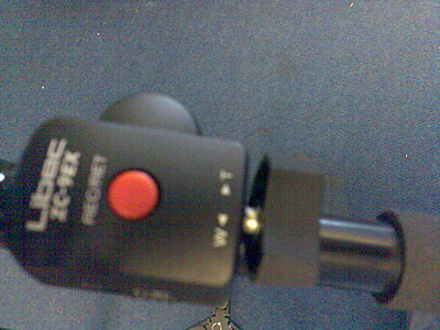

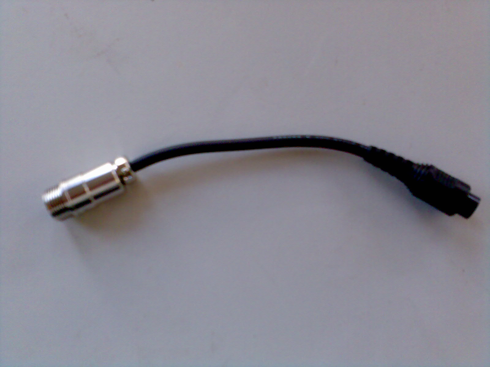

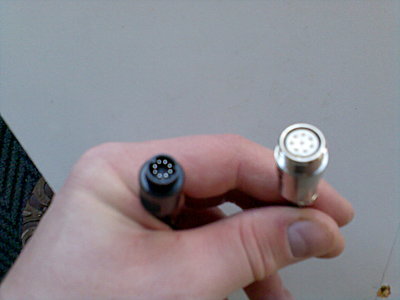

The libec ZC-9EX is the same as the Libec ZC-9pro (i think that's what it was),with an adapter lead,i know because i tried both on my EX1 today,i used the same adapter lead with both controllers.Anyone out there with the ZC-9pro maybe able to buy just the lead,it's about 100mm.
Chris Hurd,I took some pics,how do i upload ?
Paul.

Sussed it,here's the pics
Lanc Controller for the Canon XH A1-libec-ex1-3-.jpg   Lanc Controller for the Canon XH A1-libec-ex1-5-.jpg
Lanc Controller for the Canon XH A1-libec-ex1.jpg   Lanc Controller for the Canon XH A1-libec-ex1-8-.jpg
