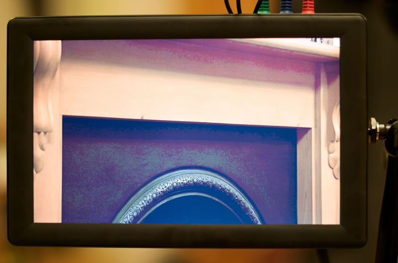

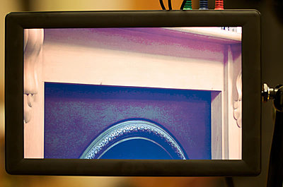

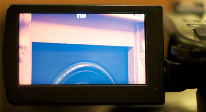

Here's a two more images showing what I'm seeing, you can clearly see the colour noise on the Dp1 in the gradients of the shadows and on the fireplace in the black surface. This noise is not present on the EX1's LCD.
and... you probably haven't calibrated the display....
Did you see anything like this with yours at default settings Trevor? If you got the same effect and corrected it I'd love to know how you did it.
regards
Paul.
"blue gun"
A basic - but not entirely accurate to the DP1 - set of instructions can be found here: http://www.glennchan.info/broadcast-...alibration.htm
Trevor Meeks is online now   Reply With Quote

Could it be that the noise problem of Paul Joy has something to do with the PAL standard ?

Location: Norfolk, UK
Posts: 510
Hi Peter, good thought, I just tried switching my EX1 to NTSC and it seems to stop the odd colours that are appearing sometimes. If I point my camera at a white bed sheet I'm seeing areas of blue pixels in the gradient areas when in PAL mode, but in NTSC these do not appear.
The colour noise in dark areas are still the same in both modes though, well lit areas seem okay but any shadowed areas or dark objects are not being displayed correctly.

I did a long testing session today to calibrate my dp1 and "master" the controls. Seems to all make sense now. If you go into advanced and edit the blue color temp setting to have R and G at zero, then the "blue" color mode works exactly like blue gun. After mucking about i feel like I've got the bars really close. There is some issue where blue light spots, like sunshine in a dark tungsten room, are showing up as extra-blue. I'll keep playing around to see if i can minimize it.
I've used far more expensive monitors that couldn't get this close for colors (and obviously, not rez). I really only counted on the dp1 as being a focus monitor, but I'm thinking that contrast and broad color might be judged with it as well. Mighty exciting.
As to the noise/pal issue... I can reproduce this, but only on the analog input. HDMI doesn't show the same color banding. It appears that the digitizer loses detail in dark underexposed areas. Not sure yet if thats a pal-only thing.
Are you saying it does that odd banding behavior with the component input or composite? If it's with component then that's a definite deal breaker for me since the A1 has no HDMI. :-\

Old July 9th, 2009, 01:05 AM   #180
Location: Motukarara, New Zealand
Posts: 201
The banding showed up on the component input, yes. However, for me it only shows up in the darkest details, where the on-camera lcd was showing just straight black, so i'm not really worried about it. Anything even remotely lit is looking pristine for me.
