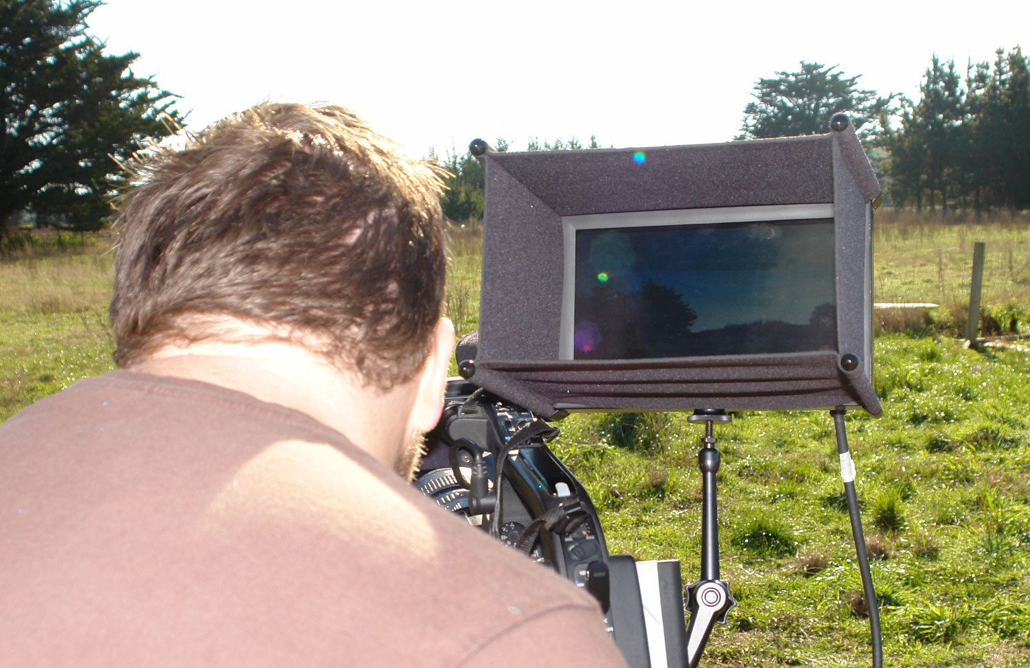

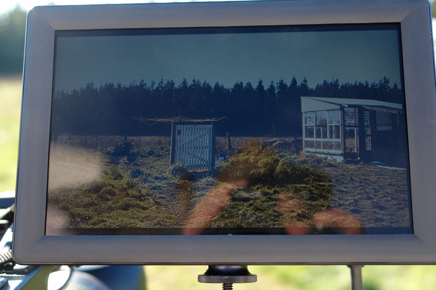

Down here in New Zealand, the hole in the ozone layer sits over us all summer long, and while i cant say if it alters the "brightness" of the sun, it lets in a whole lot more UV, and at least to my eye, makes things a whole lot "squintier" than an old fashioned Texas summer day. (as long as i'm making up words, its also a whole lot "sunburnier" too.)
My macbook is supposedly around 300 nits, and if i'm outside during the day (even in the shade), the backlight on the screen makes no difference on or off. Thats the same with the dvd player a friend bought for a framing monitor, a sony pro lcd I've rented and every field CRT we've ever shot with here. Even with sun hoods, its not uncommon to see a director to also be under an umbrella AND with a sound blanket/towel draped over the monitor and his head like an old timey photographer.
Not being transflective, i didn't expect anything different from smallHD. However, doing tests in the harshest afternoon sunlight, we were pleasantly surprised to find that you could actually see the image on the dp1. Now, i'm not claiming its clear as day or anything, but I've used it several times now on my advantajib in horrible lighting conditions and been able to see enough for framing, which surprised and pleased me.
The dp1 sunshade is pretty clever and makes a huge difference if you are up close to the monitor or trying to prevent sun spill onto the screen. However, like all sunshades, if you're on a steadicam or a jib that doesnt keep the monitor positioned, then sunshades are often more nuisance than help.
So, i concur that its totally subjective, but in my experience i found that the dp1 performs better in sunlight than other monitors in the same size/class. I considered the xenarc transflective before i got the dp1, and would be curious how it fares (i've heard conflicting reports).
The dp1 is very reflective and definitely works best outside with your head shoved into the sunshade to block reflections from behind, but for me where numerous monitors both cheap and costly have given me basically *no* image in sunlight, the DP1 gave me "some" image - enough for framing and sometimes focus, which saved my butt at least once. -- and when I have needed critical focus, having the dp1/sunshade on the camera has allowed me to move in and see what i needed.
I dunno if i'm a rabid fanboy or not, but i expected nothing in sunlight and got something I was able to use, so that was a big happy surprise for me.
Not that these tell you much, but here are a couple random shots i took of field test of the dp1 with and without the sunshade in full nz sun. As a funny anecdote, the next time i worked with Kirk, (the dp in the photos helping me review the monitor) I went to pull out my dp1 and he pulled one out too. He was impressed enough with our various tests that he bought his own. heh.
http://www.dvinfo.net/forum/attachme...1&d=1254645149
questions or criticisms of what i said, please holler!
cheers,
-andrew
