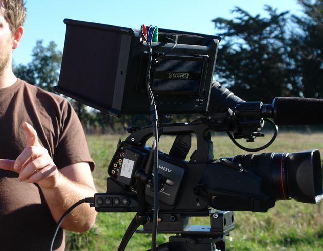

Hey all, just ordered the DP1 today and I'm curious what sort of mounting options I have with the JVC HD110u? I'd love to be able to mount it on top of the camera of course, but I'd also like to know if there's some sort of arm that could attach to the tripod and give me an additional mounting option.

mounting options
there's been a few threads discussing this, but here's what works for me:
I have a manfrotto quick release that i mount to my tripod head. Manfrotto by Bogen Imaging | 357 Pro Quick Release Adapter | 357
On the side of the QR base are some threaded holes for storing extra camera screws. Instead of a camera screw, i screw in a noga arm: Noga | DG14CA-SA Cinematic Arm with Hot Shoe | DG14CA-SA | B&H
Then, on top of the noga i have mounted a giottos mini ball head: Giottos | MH1004 Mini Ball Head | MH1004-320 | B&H Photo Video
You'll pay a couple hundred for this setup, but its simply magic. The arm is long enough to mount the monitor wherever you'd want it around the camera, but its compact and out of the way. You dont put any stress on the camera (especially not the dicey hot shoe).
The ball head is a little redundant to the function of the arm, but i've found that often i want to make a minor adjustment to the angle of the screen without wanting the entire assembly to go floppy. Plus, with the ball head, i find it easier/safer to mount the screen to an already mounted arm.
Adding a lock washer between the noga and the QR protects you from accidently unscrewing the arm from the QR plate. (just a FYI).
One DP i film with really wanted the monitor on the cam when he did some jungly handheld stuff. I messed around with the hot shoe adapter from noga (i hate their shoe adapter) and was never happy with a setup. Finally i just removed the QR base from the tripod and let it travel with the camera- noga attached. Worked an absolute treat. A minor addition of weight, but at the bottom of the camera and without any of the "floppiness" you can often get from a jiggly shoe mount.
Thems my opinions anyways. Gotta be cheaper solutions out there, but i found this one to be my fave. No stress on the camera, and while on the tripod the monitor moves with the camera like you'd expect. Also, you can quickly and easily detach the cam from the tripod either leaving the monitor behind (release the QR plate) or take the monitor with you (release the tripod plate).
Here's a pic of the noga and smallhd to see what i'm talking about. (this rig happened to already have a manfrotto QR on it, so i just used it.
http://www.dvinfo.net/forum/attachme...1&d=1257458068
found a few more pix i had previously uploaded:
http://www.dvinfo.net/forum/attachme...s-monitor1.jpg
http://www.dvinfo.net/forum/attachme...s-monitor2.jpg
