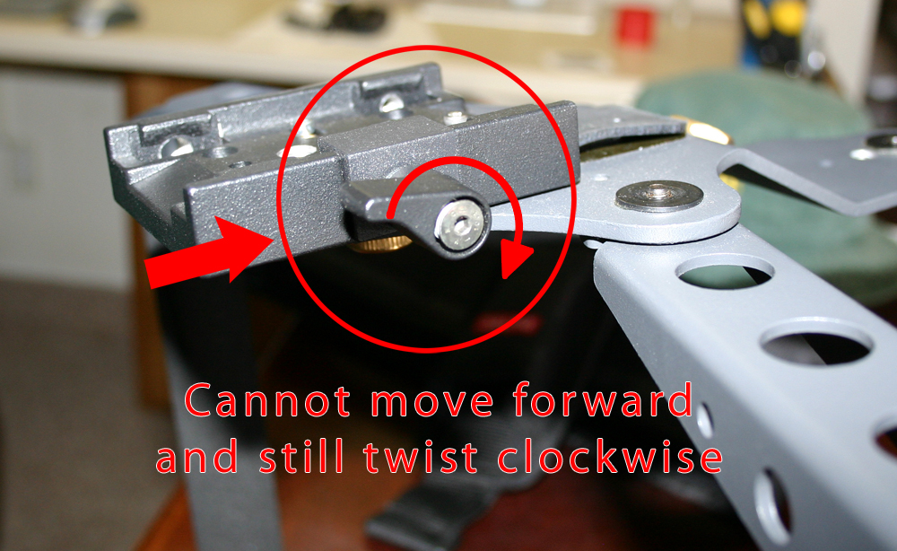

I have the optional Quick Release for the rig. The receiver part is mounted to the top of the Rig. However, I have to keep it back farther than I'd like, because the tightener on the right side of the receiver won't turn when it's sitting forward (see picture). Am I doing something wrong here? The docs that came with the rig say to set the camera so it's balance is shifted forward for best stability. As near as I can tell, I just can't do that.

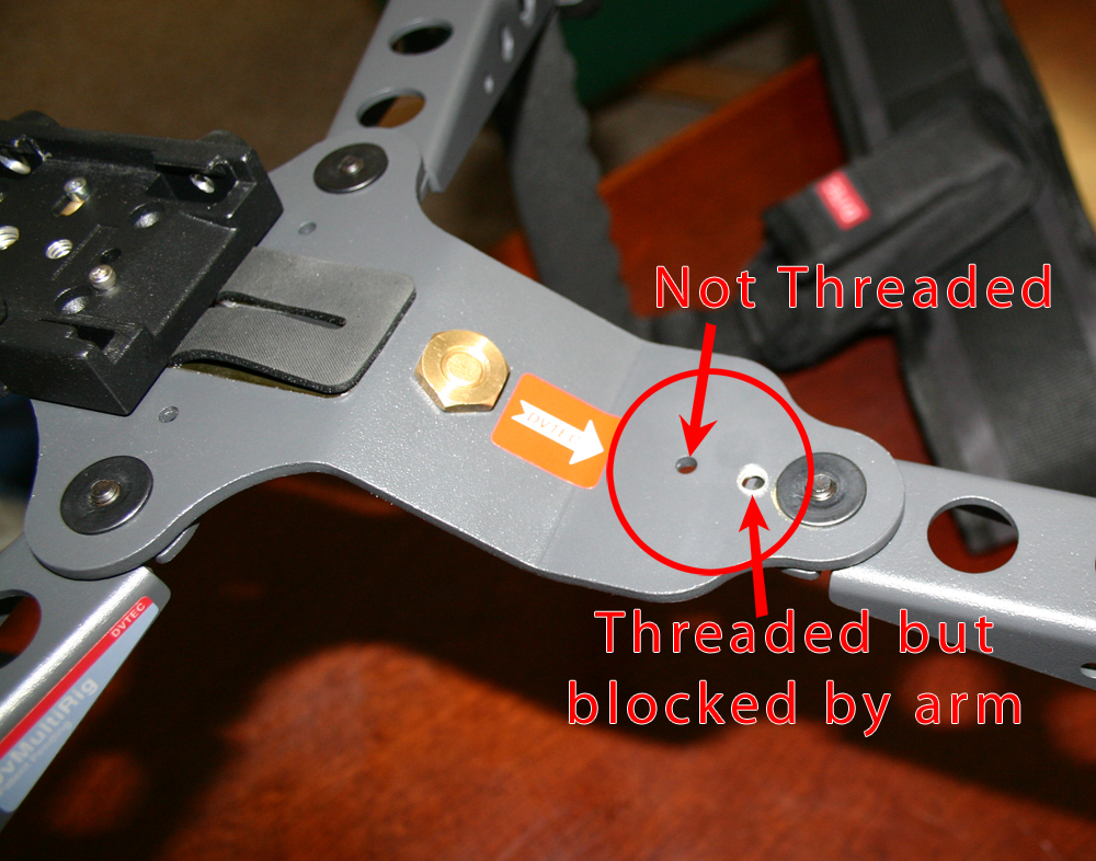

3. Threaded hole. There is a threaded hole toward the front of the base, next to the foremost arm of the rig that is inaccessible from the bottom of the rig, because the swivel-point of the arm covers it up. Consequently, it's also not deep enough that I'd feel comfortable threading anything into it from the top. The only reference in the documentation that I've found to this hole is this line: "For quick insert to and from your tripod head, Mount your cam. tripod plate to the front 1/4" thread and registration hole." There is another hole behind this, which is probably the registration hole, but I can't see how these holes can be used. (See Picture)

For the QR plate, I use the same setup and I have mine set just behind the lock nut on the plate. The lever works just fine. Actually for a while I had it over the lock nut and the movement simply wore a small groove into the lever and that has no adverse affect on the mechanism. Keeping the QR farther forward also helps the CG which helps in making smooth moves with the multirig.

OOOPS WAIT! I just looked at the pictures again and realized you have the QR plate way to far forward, bring it back towards the rea of the unit otherwise all the weight is out front which does the smae thing as I said earlier but in reverse. You want the unit to carry the weight not your arms.

2. Camera position - Pls. note:
You can adjust the locking lever travel sector. (180 down or up)
Slide in the plate (no camera) lock the lever, push it out and set the
locked positing. pointing back or forward.
We make 501 long camera plate, much longer then the original 501 plate, This allows more front- back balancing range.
You have one slot in the rig and another in the camera plate, plenty of
range.
3. the front holes you have mentioned are for mounting a camera plate directly to the unit when used without the front arm / grip in the Stabilizer Plus mode.

I have to say, after Don's post yesterday, I figured out the method of adjusting the locking lever as you describe here, which allowed me to put my camera *much* farther forward, and the stabilizing affect was drastically better. I'm still working on my walk, etc. but this thread has already given me some giant leaps forward. I actually have the longer 501 plate that you make, and it probably helped as much or more than the locking lever adjustment.
That makes sense with the front holes.

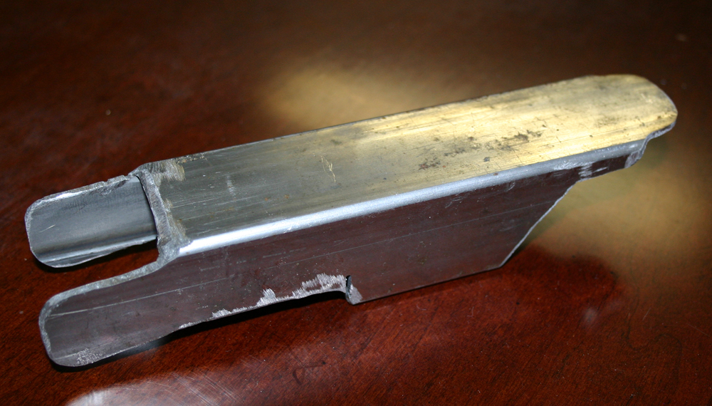

I'm actually still pressing forward with my plan to add a counter-weight to the bottom of the rig. I'm no engineer, but I keep thinking through it, and I can't help but think it will help with the overall stabilization. I'm doing this by creating a replacement front arm (see picture), that will swing back under the rig (with a larger channel through the middle for the stabilizer pod to pass through) and, instead of a grip that folds down, it will have a pole extending downward with an adjustable weight on the bottom. I'm making my own replacement arm, because I don't want to permanently modify anything about the original rig. Anyway, the tinkerer in me just has to try it. I'll post pictures when I'm done (I'm probably 2/3rds there now). Any thoughts on this?

Quite clear, and much appreciated. I'm far enough now with my "new arm" that I'm still going to press on, but I'll try those techniques you described too. Don't worry, I'm not a total novice with this stuff. ;) (see Alex Chamberlain's 1995 Geo Tracker)
