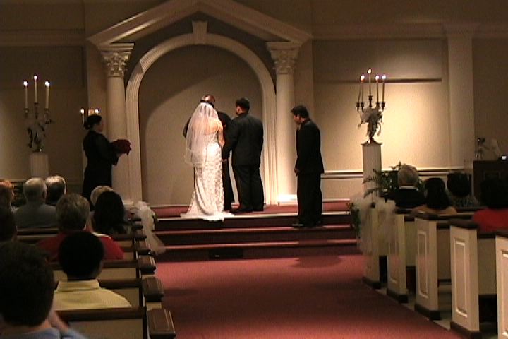

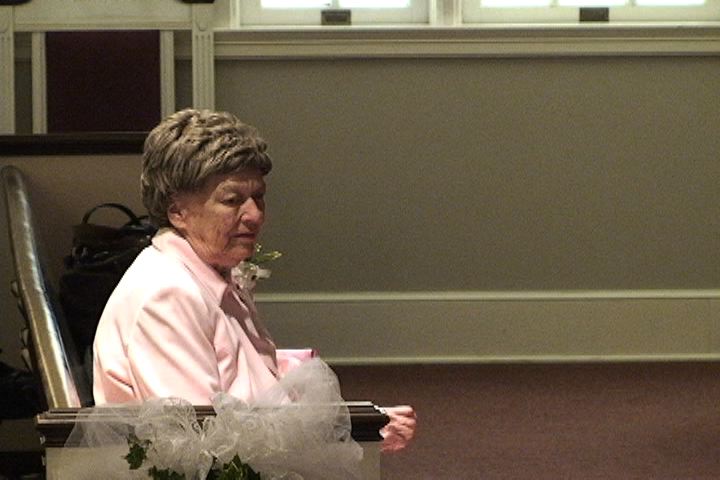

O.K. - this is insane!!!
I have turned on the Data option in the menu, and I've been watching what the camera is doing. I generally use manual settings.
For my grainiest footage, I have found out that my F-stop was at a 2, my shutter speed was at 60, and the auto gain was at 15-18.
Ready for the best part?
At the absolute grainiest, when the gain hit 15 - 18, the subjects were STANDING DIRECTLY UNDERNEATH CAN LIGHTS. Folks, the Lord Himself couldn't have illuminated them brighter.
During the b-roll the gain stayed between 3 and 6, then throughout the ceremony it camped out at 15. Here are some stills - the wide shot from behind was my wife's can Elura 85.

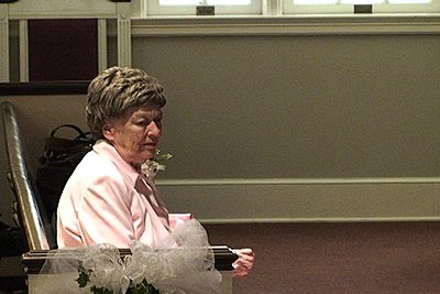

Here is still number 2...
Sorry for the mess-up.
Remember, he is standing underneath the lights...

while the HD1000 will never compete with the PD series, DSR series, EX series or Z series, for a 1 chip camera that freeze you posted really doesn't look all that bad.
Unfortunately grain is very hard to get rid of with hurting the remainder of the image but I think Neatvideo might be the way to go.
Color, levels, gain (in post) isn't going to help. Again though it really doesn't look all that bad at least based on the freeze you posted.
