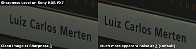

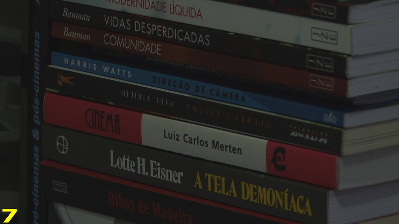

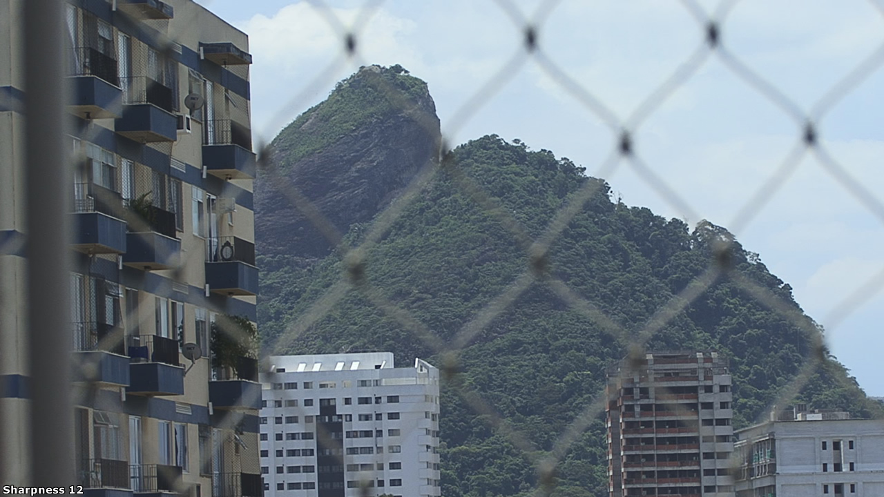

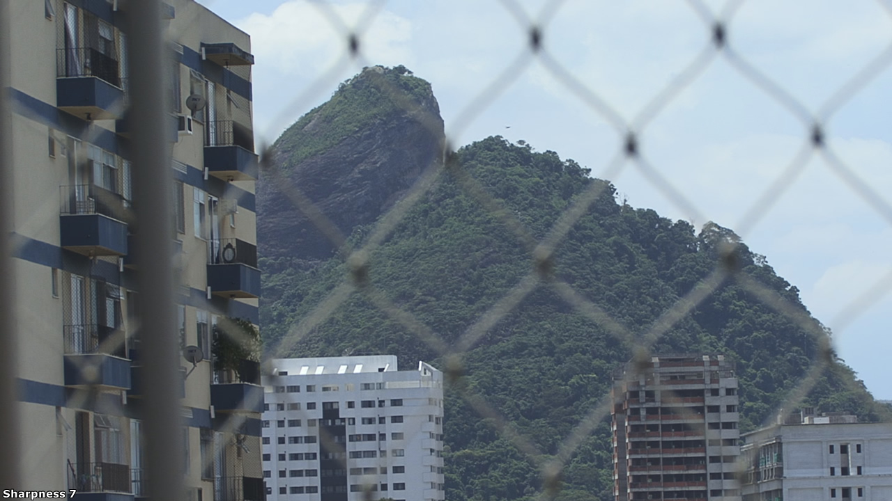

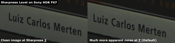

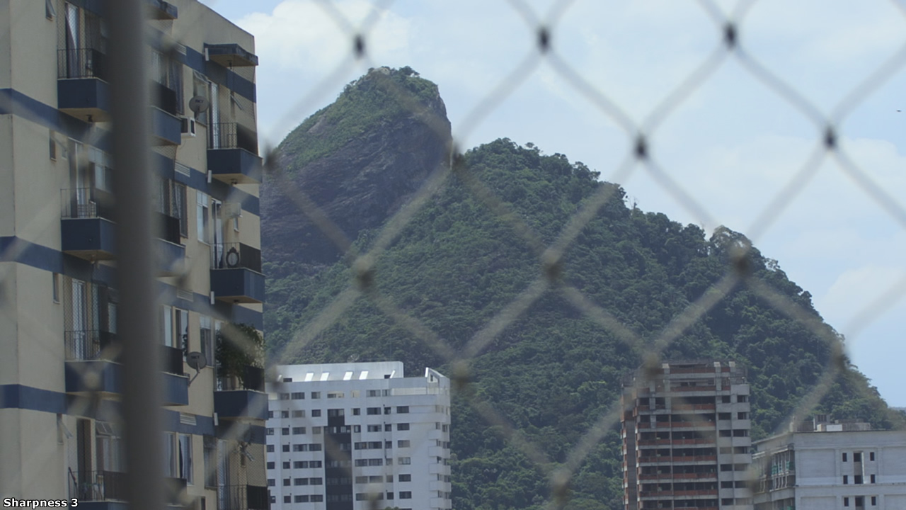

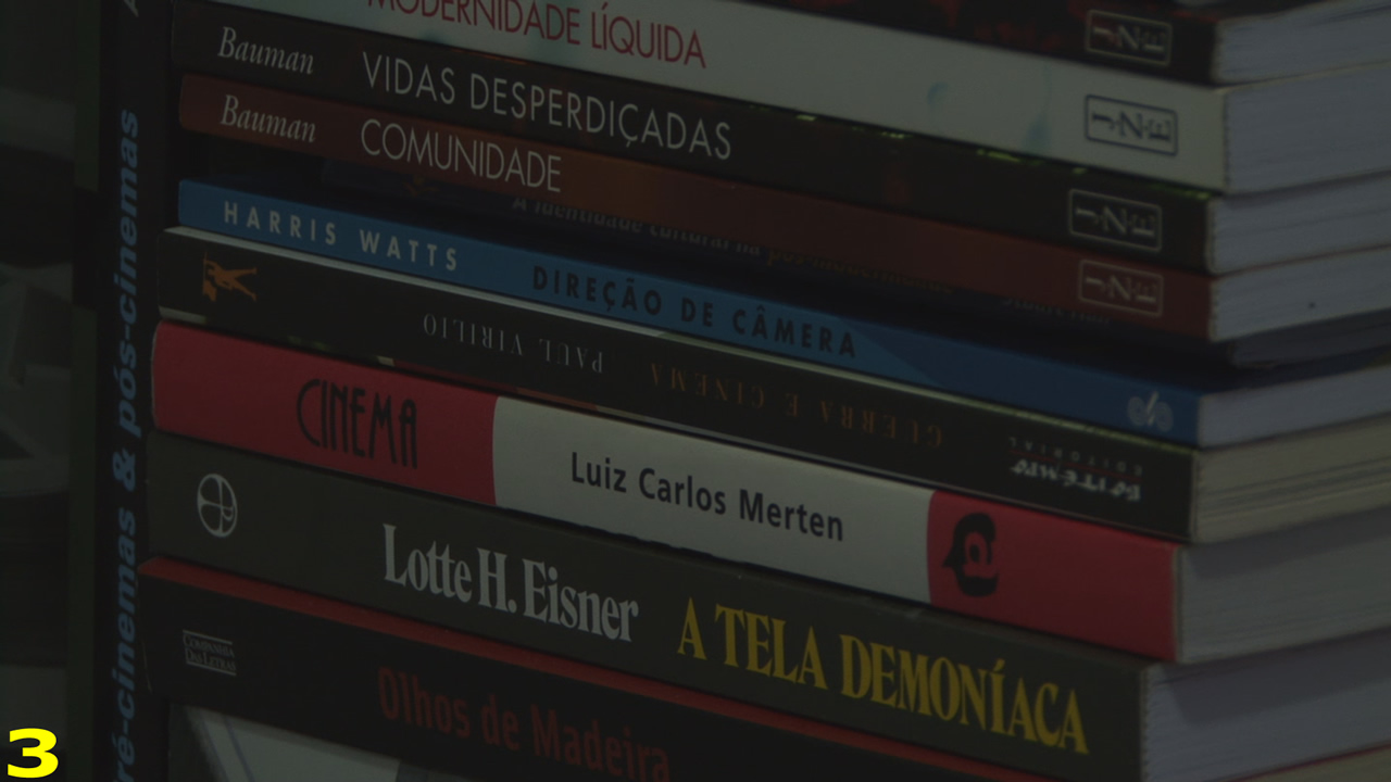

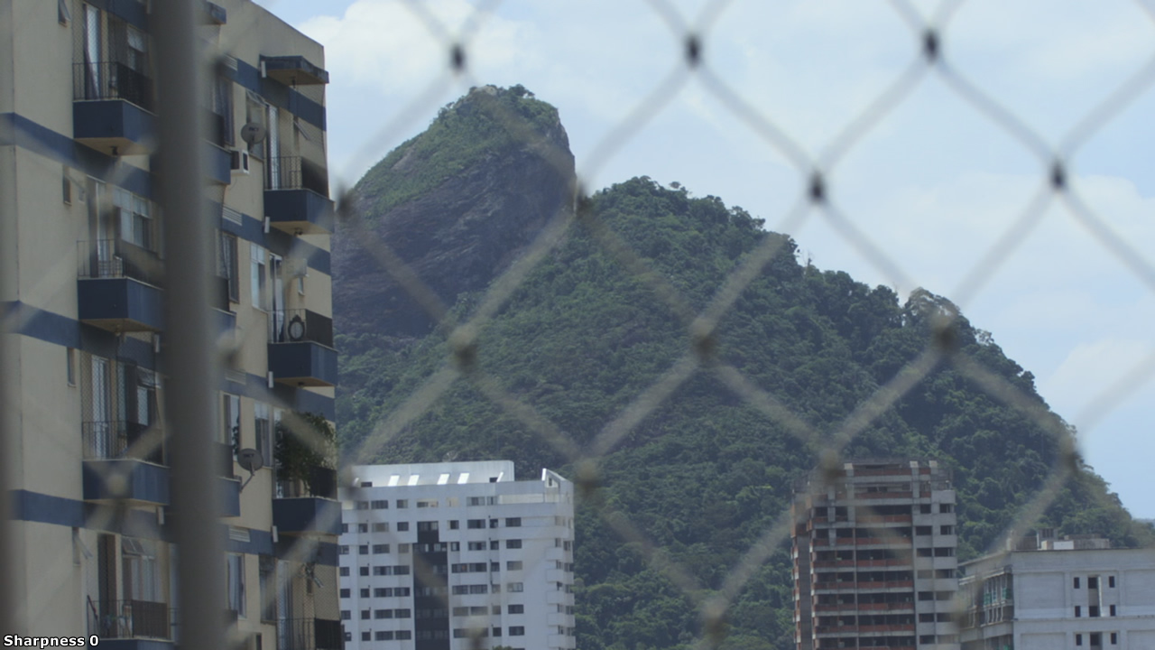

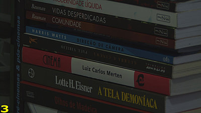

Sharpness and Noise
Ok, here's my take on the relation between the sharpness setting and the noise in the image.
After this test I started using a maximum sharpness value of 4.
Notice on the mountain example how unnaturally sharpened the trees look when sharpness is set to 7 (camera default).
PS: I still have some doubts about color settings, like how should I set the PP so I have the largest headroom when Color Correcting?

Old April 6th, 2008, 04:20 PM   #43
Location: Stocksfield, England
Posts: 30
I agree totally with your decision to use sharpness 4 and no more.
This is the figure I settled on some time ago for my V1E.
I would rather have a natural image, if you examine the top of the foliage on the hill on your sharpness 12 image there is a thin BLACK line edging everything, that is not natural.
You would not see that with your eyes when you are there.
Likewise if you examine the edge of the pale yellow or cream building at the left there is an unnatural WHITE line edging it and the blue sky.
I believe this is all that digital sharpening of images is, no more than applying black and white lines to the edge of everything, it's a trick to fool the eye into believing the images are sharper than they really are.
Love my V1E on sharpness 4! not to mention the extra resolution in 25P mode.
Claire
HVR-V1E, VCL-HG0862K W/A, EDIUSwith HD Expansion
