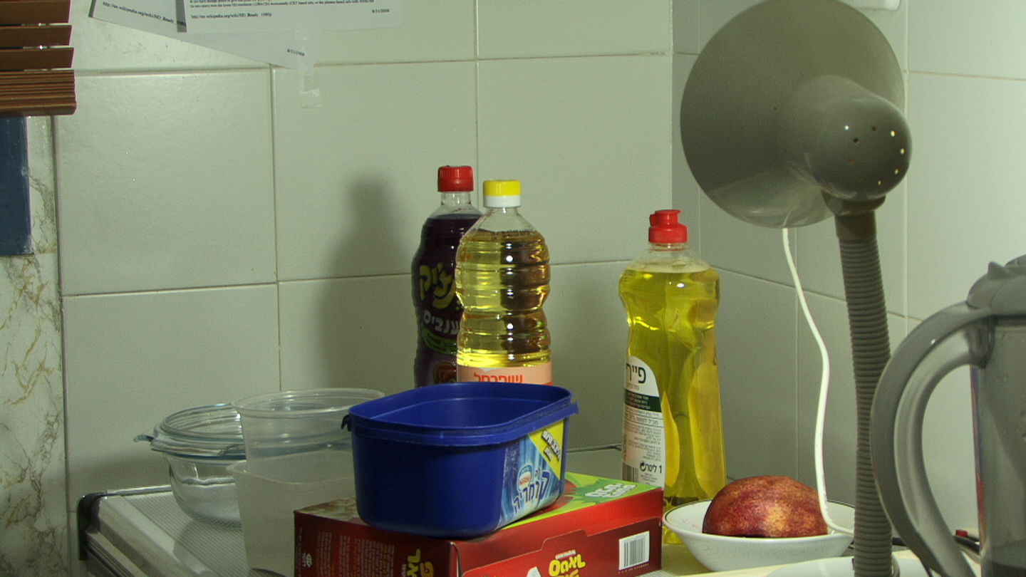

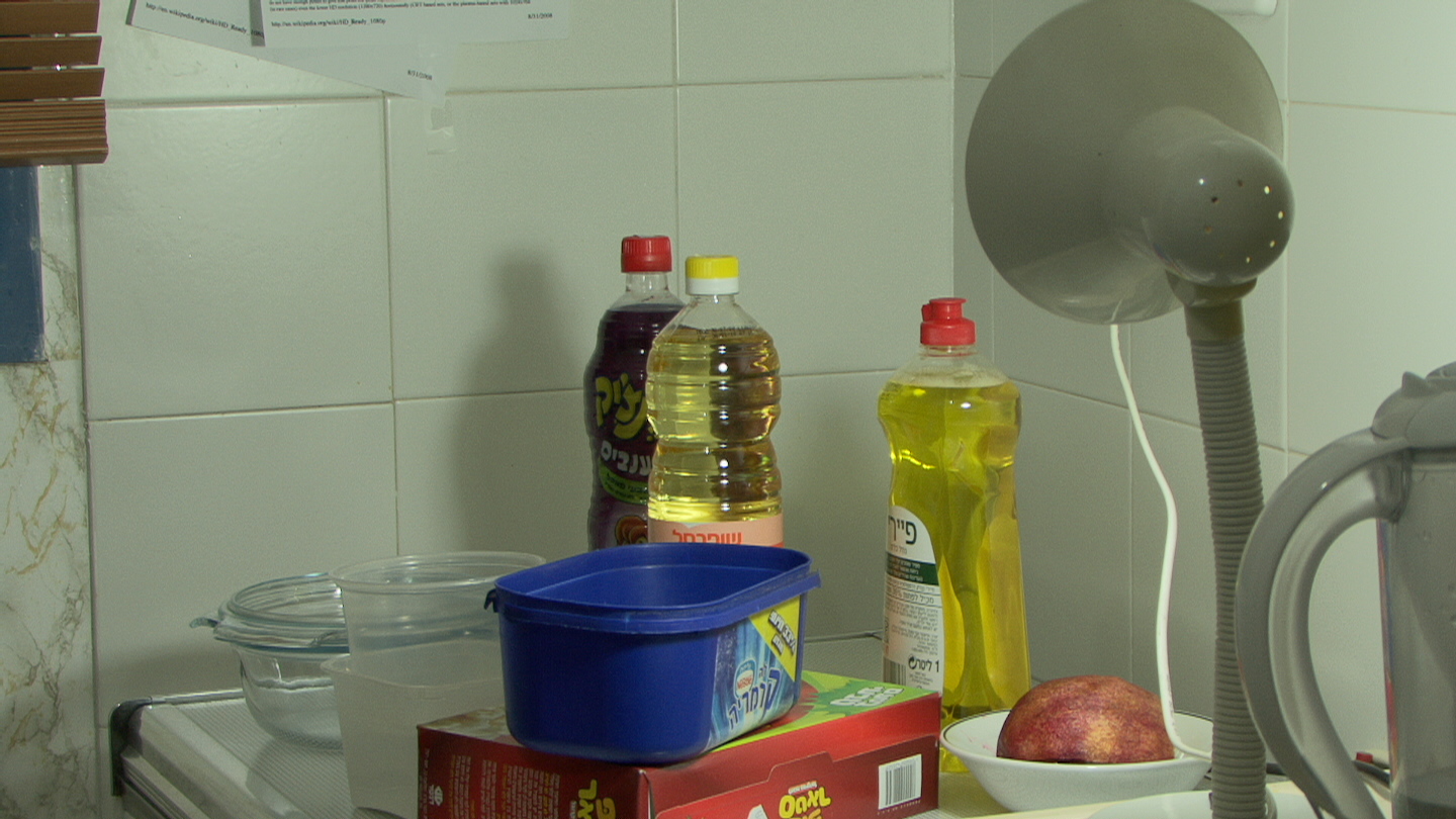

I’m not Robert, but I can answer your question too.
I think that the widespread judgment of CINEMATONE Gamma as a setting crushing the picture blacks too much is ... a little bit exaggerated.
Just look please at these two attached screenshots; the left one was made in the standard video mode, and the right one was captured when CINEMATONE Gamma plus SPOTLIGHT were activated (in such mode the function of enhanced contrast is unable).
Arkady Bolotin is offline   Reply With Quote

Good information. Currently I shoot with a DVC-80. I prefer to run my exposure manually and do a white balance at center stage with full stage lights. If I can't get the white balance, then I use the indoor setting on my GL-1 but the 80 doesn't have a way to lock it into the indoor. Of the 2 pictures I think the one on the right looks better.

Superficially the one on the right will grab your eye--it has the greatest dynamic range, with the blacks crushed.
The problem is when you use the cinema gamma on scenes that are darker you may have a lot of picture information in the crushed black portion of the curve that is gone forever. It is in bright scenes where you have a lot going on in the brighter areas that the crushed black works. In darker scenes you have to stretch out all of the picture info in the dark areas to create more image.
So, I would rather leave myself the option to crush the blacks in post!
