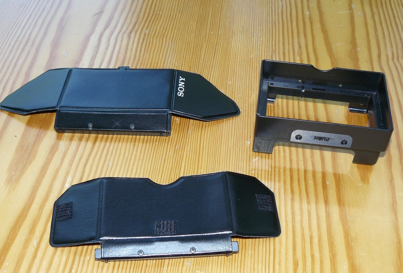

Tim, those are excellent pics. Well done. Thank your for your effort, much appreciated.
I will be ordering mine directly. This is clearly a nice little hood, and it cannot hurt a thing, especially at under $50.

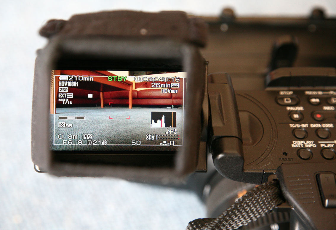

My Z5 viewfinder photo!
Originally Posted by Tim Akin View Post
Here's some pics of the Sony LCD hood for the FX1000.
The viewfinder in these photo's looks much better than mine. I have attached a photo of mine with the brightness on high and the backlight on high. Hazy bright day.

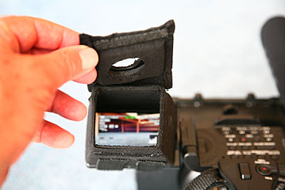

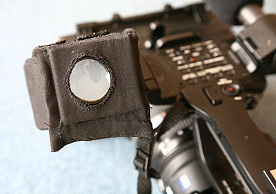

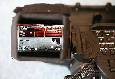

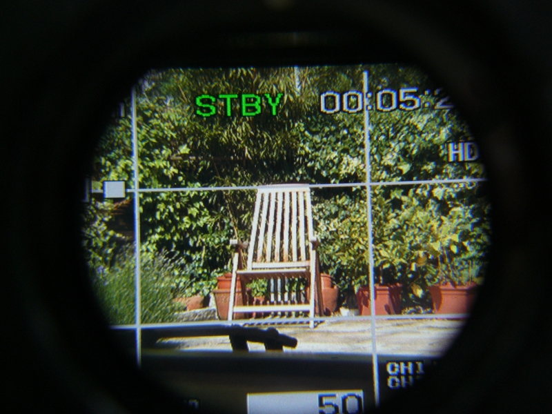

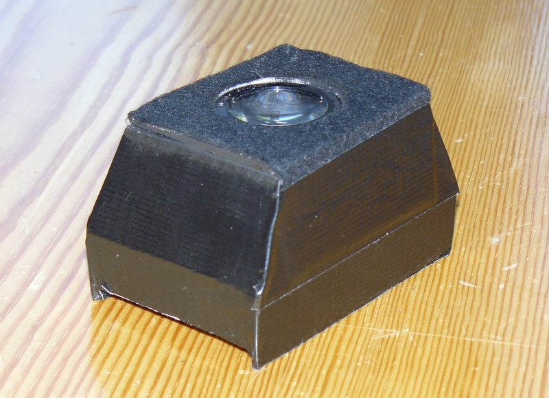

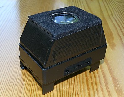

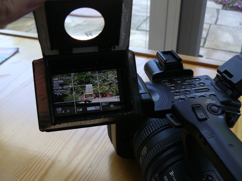

I just made a prototype for the lcd screen of my Z5. I used the originitial Sony lcdhood. You can very easy take away the upper part. The rest is made of 3mm photo carton. The inside is wiith black felt. The lens is from the viewfinder of my old Mamiya 645 photocamera. The result is very good, only left and right 2 or 3 mm is missing.
Dirk PEL Karlsruhe Germany

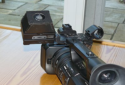

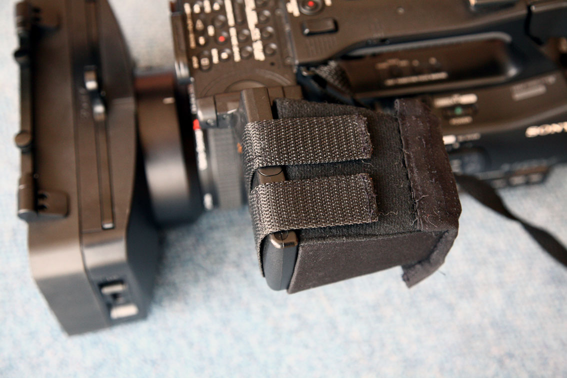

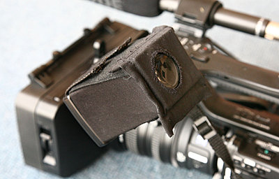

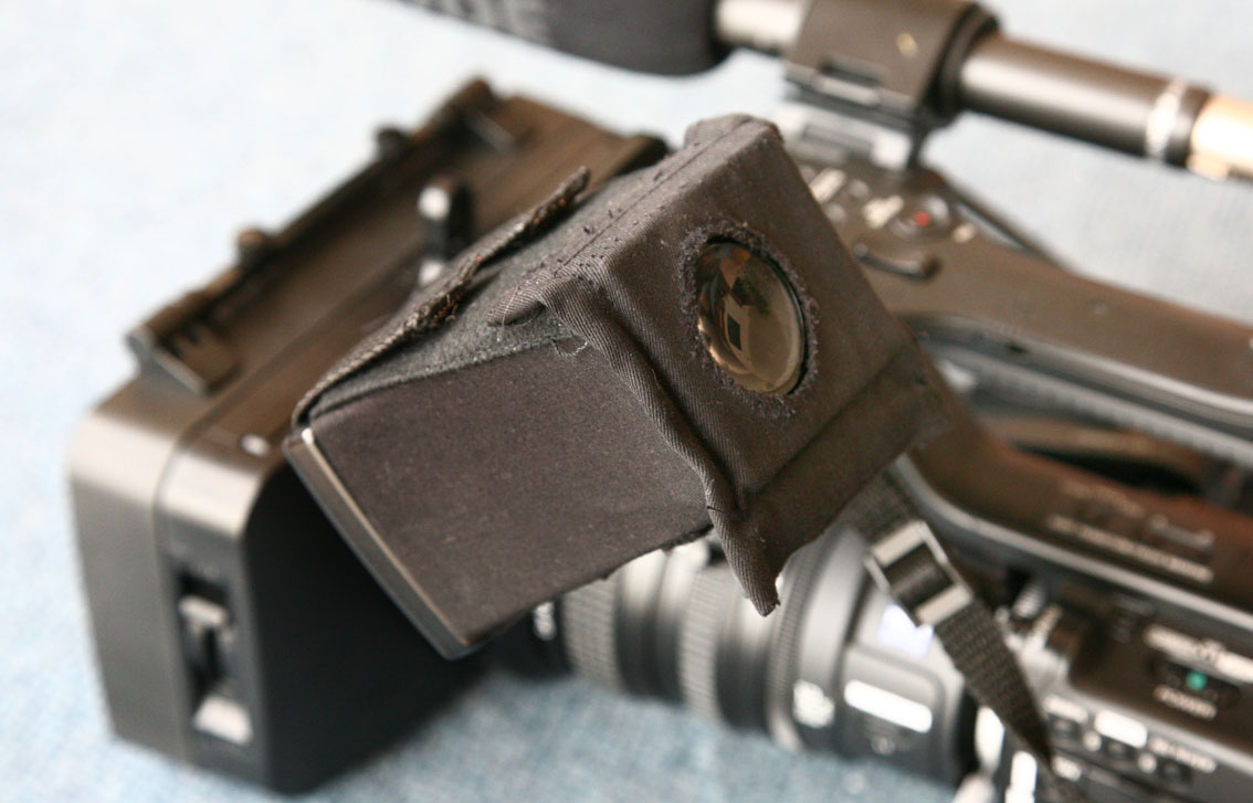

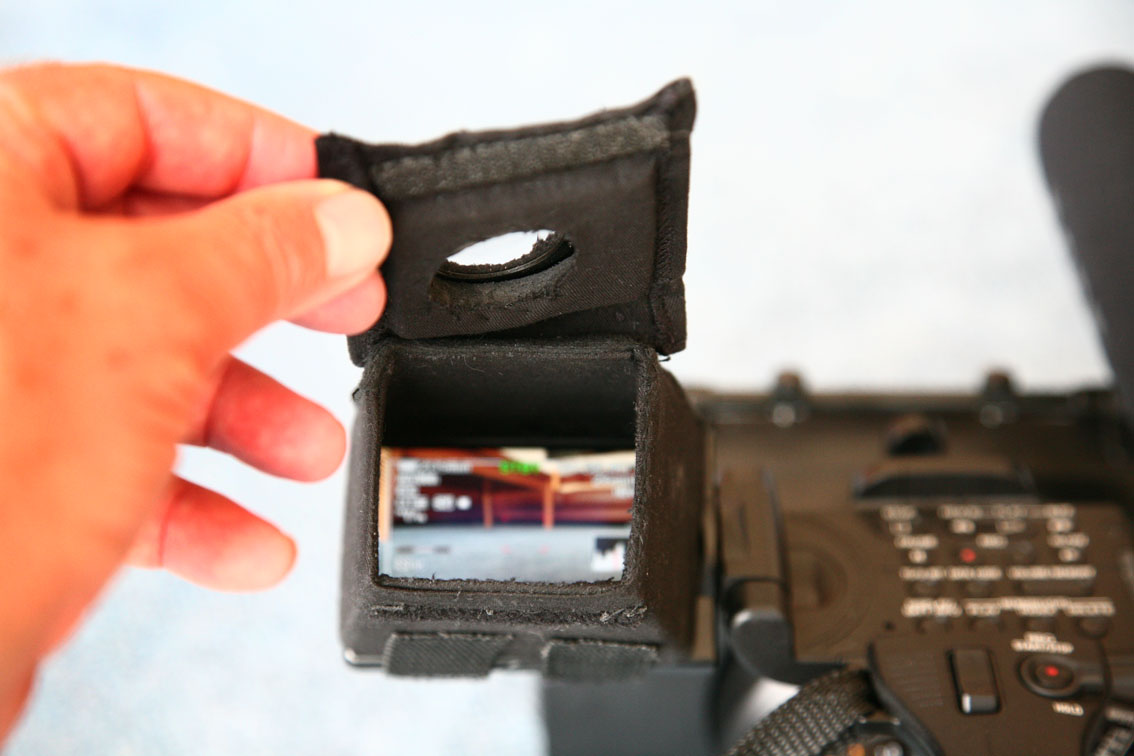

With a lot of sowing help from my fantastic wife, I've made a comparable contraption, that attaches to the screen with velcro. I used the focusing ocular of an even older Mamyia: the C33. As you can see on the pics, I put the ocular out of the centre, more to the left, as I'm looking through my left eye when focusing. This way my Z7 (which has the same shape and LCD-screen size as the Z5) becomes a shouldermounted camera. Especially with the wide-angle convertor on, that is a blessing, because the combination is quite heavy.

Shows very good! It was at my opinion a of compicated sewing.
Today i usedthe system for filming a rhododendron exposition. It worked fantastic.
de groeten van Dirk Pel

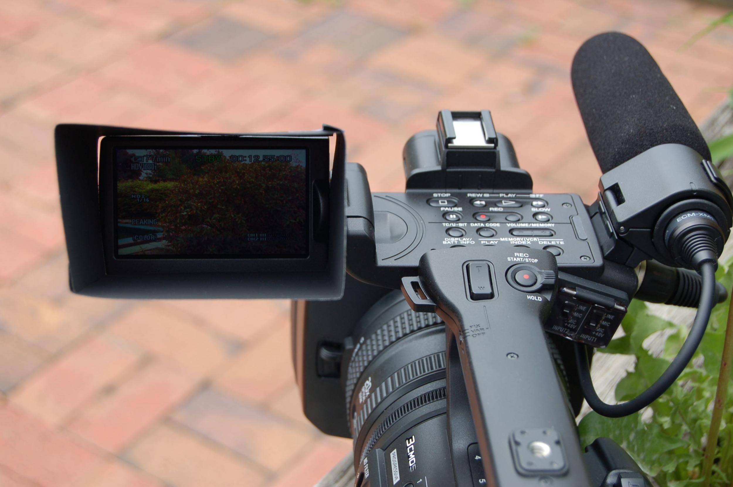

Thanks for these Tim - do I take it from the top photo that the hood can stay attached when the lcd is folded back in place? - I'm assuming it's folded back in the face-up position. Great if so, makes it worth the little extra.

That would be correct Paul.
