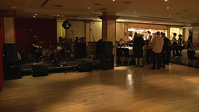

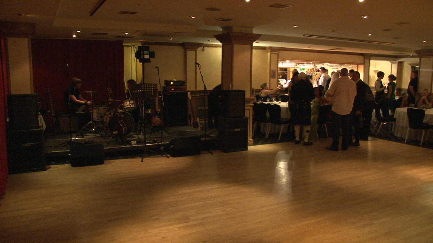

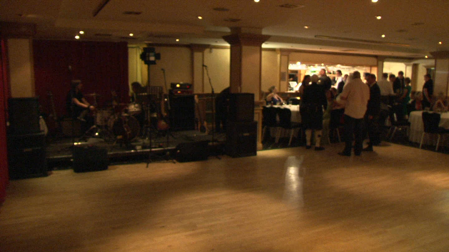

Hi guys, been happliy shooting with my Z5 since April this year.
At this weekends weddings, I noticed a problem with the focus, the very same problem that happened to my FX7 last year, this problem seems to be know as 'Back Focus'
My normal method of focussing (zoom into full tele-zoom on subject, ajust focus, then zoom out to desired framing)
Problem is that all of a sudden, when I do this, when I zoom out to wide, the whole frame is out of focus.
I took some stills at todays wedding to illustrate the problem (not the best lighting conditions but its fairly obvious that there is a problem)
Pic 1 = Fully zoomed into object (a light stand) I adjusted the focus, it read 9.8m.
Pic 2 = After pic 1 was taken, zoomed out to full wide, didnt touch the focus ring.
Pic 3 = After pic 2, I then adjusted the focus as it was obviously not correct, the focus meter read 0.3m
This was done with macro focus set to 'on', and focus assist set to 'off',
I tried all combinations of macro focus and focus assist, but the problem was the same.
I didnt think it would an issue with any of them as I have been shooting with the above settings since I got the camera an its been fine (until this weekend)
Has anyone else had this problem with a Z5/FX1000?
I'm covered by the silver support thingy, but I can't afford to be without my camera, even for 7 days, as I have weddings to film every friday and Saturday till October!
Any help, advice, suggestions as always are much appreciated
James
'Back Focus' problem with Z5-pic-1.jpg   'Back Focus' problem with Z5-pic-2.jpg

Please help!
So I sent the camera back to Sony (had to send £100 hiring another Z5 over the weekend!)
They've emailed me saying this:
"Hi James
We have conducted a hot/cold testing, and checked the unit over a period of 2 days with no fault found. We have just checked the unit over now and concur with this, but would like to add the following information which may contribute to the lack of focus.
Firstly the unit has focus macro set to on (stated in notes and as camera is set up). As you know, the macro function is used when the subject is less than 3 ft from the front of the lens; you were focussing on a subject at about 9.8M (approx 32 ft). Use of the macro lens means that optimal focus is within the macro range, not at further distances.
We also believe that low lighting conditions such as the ones in the photographs may have a detrimental effect on the quality of focus.
(For a focus deviation this bad, if the lens was faulty we would expect it to generate a 6x error). To this end, because the error log is full of "Battery too hot" and "Non-Standard battery” errors we advise you to replace the battery with the original to prevent these error occurring and concealing the lens error (the error log only has 6 entries).
Best regards"
Now its may be possible that the problem has magically fixed itself, but i doubt it.
The camera is due to be delivered back to me today.
If (as I suspect) the camera has not magically fixed itself, what can I do to prove to Sony that there is problem?
I'm thinking I would go to the hire place, ask to do a side by by side comparison with their Z5, take stills etc....
Anyone have any thoughts?
FWIW, the level of customer service from Sony Prime Support so far has been less than stellar.
Cheers
James

Hi guys, I got my Z5 back from sony, and shockingly enough, the problem is still there.
Its DEFINITELY nothing to do with focus macro being on or off. The problem happens whether is on or off, likewise lighting conditions don't make a difference, it happens in bright sunlight, it happens in a dark room.
I've uploaded a raw .m2t file so you guys can see it for yourselves.
its at FILES
Ian, do you still have the letter(s) you sent to high level sony folk? I'd love to have a read and maybe 'borrow' some choice phrases.
Its such an obvious problem I cannot beleive sony repair centre 'tested it over a period of 2 days, and found no fault'
With regards to focus macro, I also thought that since the default setting was on, that it is fine to shoot with it on, i find that it gives you a better focal range (for want of a better phrase)
Anyways, have a look at the file and let me know your thoughts
Again, any help/suggestions are much appraciated.
