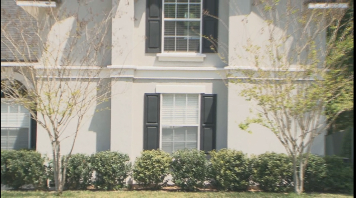

I always shoot full manual and one of the main compositional/setting places I live when shooting is at full tele, fully open iris. What I have found on both Z7s that I have is when you zoom in full tele to pull focus and then zoom out to compose the image gets slightly soft at the right and center and the left side gets very blurry. See screen shot here http://www.firstsightpictures.com/z7blur.jpg
So if you zoom into a bridal party or couple from a distance or anything at all to get a shallow DOF the focus plane on the left will be out of focus as you see the tree on the left out of focus. Yes i did do the auto and manual flange/backfocus adjustment but there was still no change in the result. This is EXTREMELY bad for any manual shooters who shoot creatively.
So Z7 users. Put the cam in full manual use ND and or shutter to bring your exposure into range and then zoom in fully to a lineup of subjects that are the same distance away if your iris is wide open it should be at 2.0, ten back out until you see the iris limit go to 1.8. In this range you should see the inconsistency at it's worst. I have already confirmed with another user that his Z7 does the exact same thing but the blur is on the right side.
Here is a short video clip http://www.firstsightpictures.com/z7blur.wmv of my closeup cam on a dance performance. You can see where I go in tight to pull focus twice during the clip and zoom out for a head to toe and it gets a little soft and then anytime the performers are in the left side of the frame it gets even blurrier. You can't see it at all on the Z7 LCD, even with peaking it looks to be in focus.

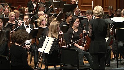

I have noticed this as well. I have not had a lot of time with the camera but I did video a classical concert last night and it does seem to have a similar characteristic that you mentioned. This might be a major problem! I cannot confirm that it is the lens or the electronics, though.

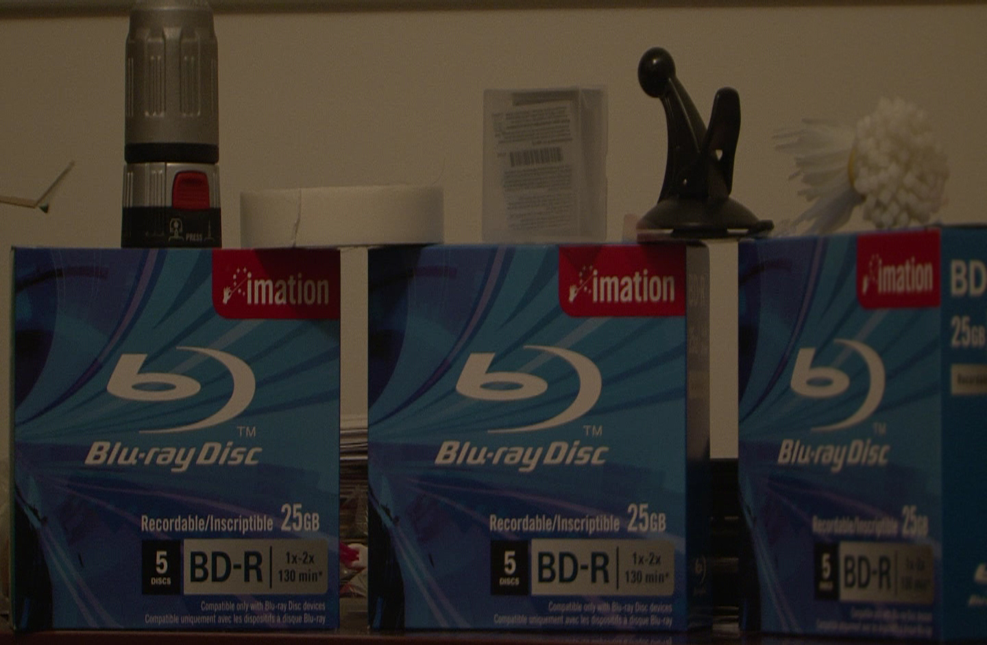

I have the wonders of this as well. Interestingly, I have a blur on the right side whereas Bruce's was on the left.
I swear I'm really losing confidence in this camera and Company.
See attached image. It's a still frame from video I captured when talking with Bruce. Notice how the blur is on the right and not the left. Each box of DVD's were equally spaced and the curviture is based on the desk. Oh, and I didn't scale the image properly which is why it's skewed.
Marshall Levy is offline   Reply With Quote

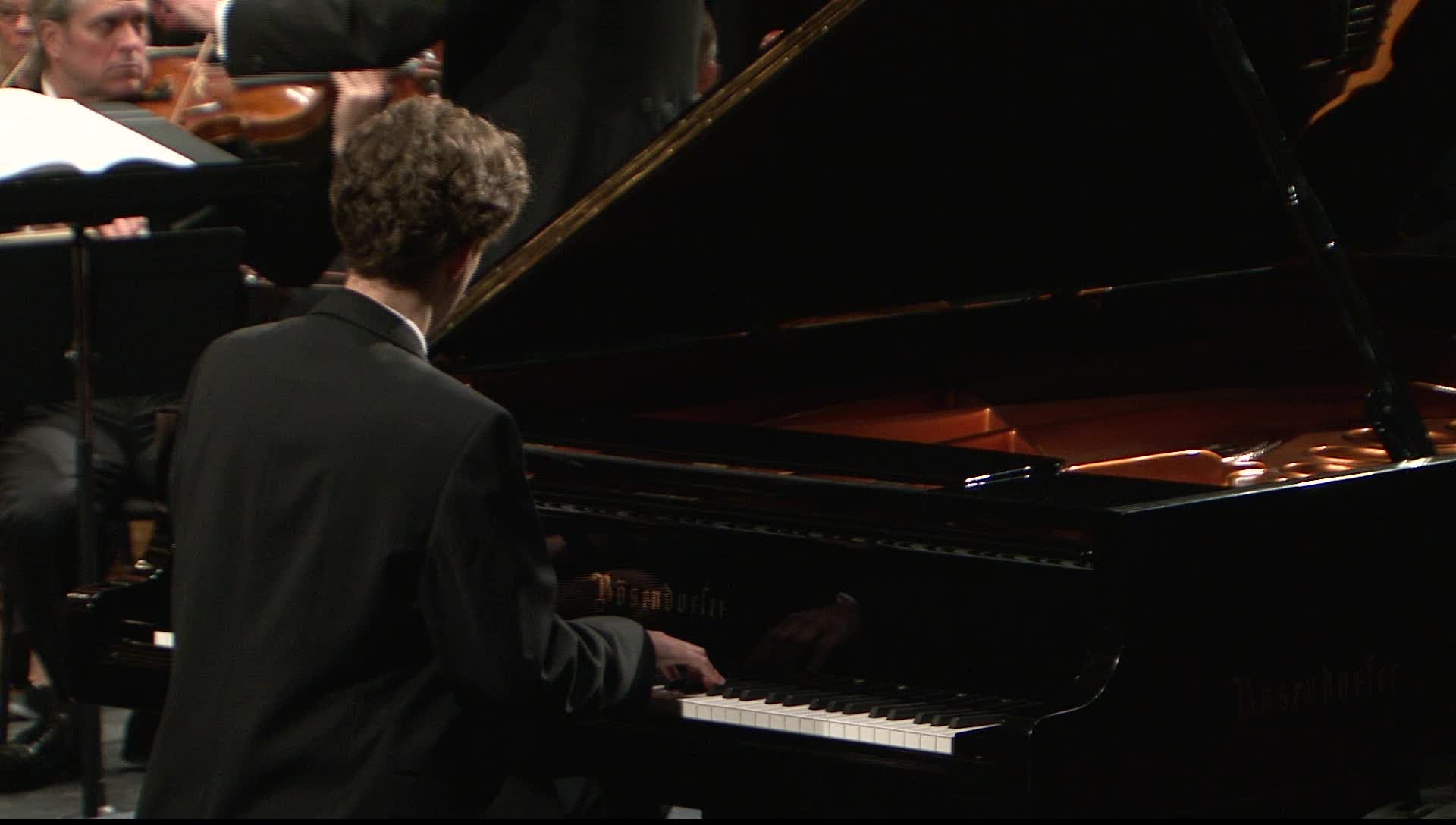

I have to reevaluate. After reviewing the footage I took yesterday it appears to be not as much of an issue as I first though. It may just be an extremely narrow depth of field and not a camera issue with mine.

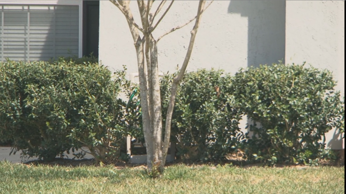

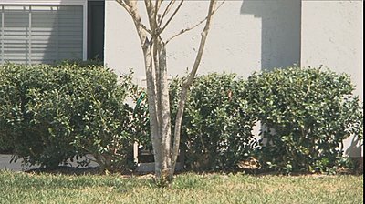

I am not sure now. Here are some grabs from you video. I don't see the issue of one sided blur on these.
kdbf
You have to watch the video. I don't know what you did to that second grab. Looks like you put a gaussian on it to even out the blur. The first grab is from where I zoomed in to pull focus and then you see I zoom out and the subject I placed in focus goes blurry but everything from the center to the right of it at the same focal length is in focus. Sony just called me from NAB and said they are analyzing everything now. So if you have a Z7 don't want to be stuck with a major issue of a half muddied up frame for a large portion of your shots you need to do this test properly.
