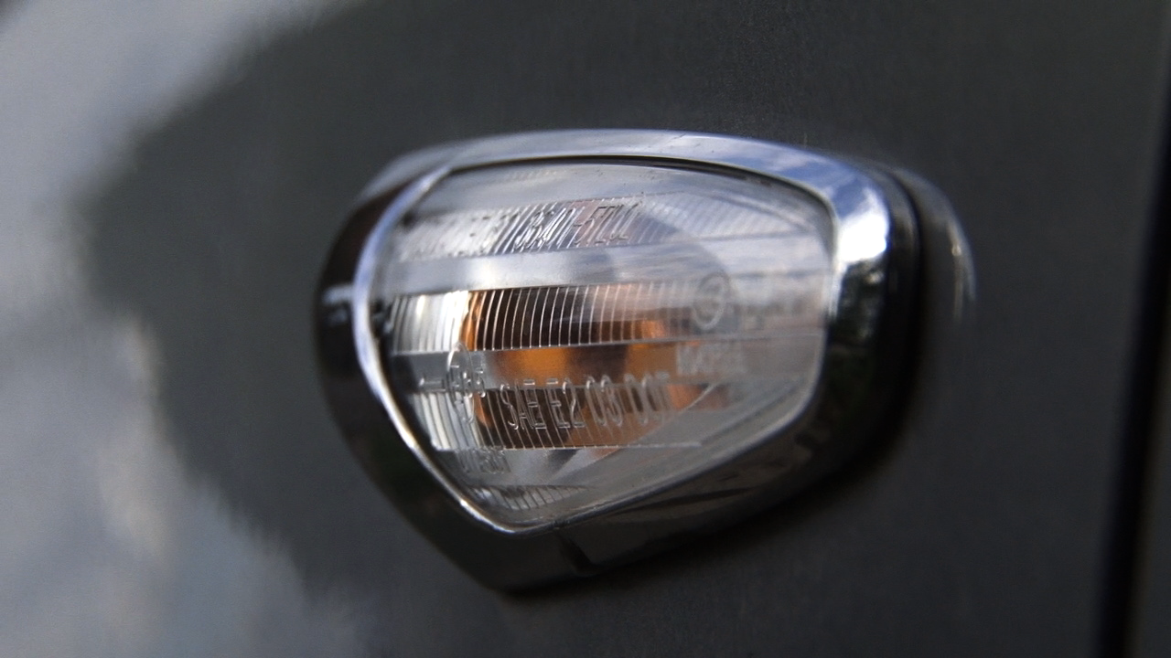

The NX5U can do some very shallow DOF looks in the proper settings. Not like a DSLR, but certainly workable if that's the look you want.

Here's an unretouched still of a Suzuki Kizashi (car) sidemarker light from an NX5U. (The light is about 3-inches long) This was recorded at 720p with a built-in ND filter and wide-open aperture, outside on a cloudy day.

I don't have anything I can show you yet. We just started shooting with the NX5U. For the look in that video you'd need to get a 35mm adapter on the NX5U or just pick up a Canon T2i. So, yes, the Sony can do a noticeable dof effect but it not the right tool for crazy dof.
