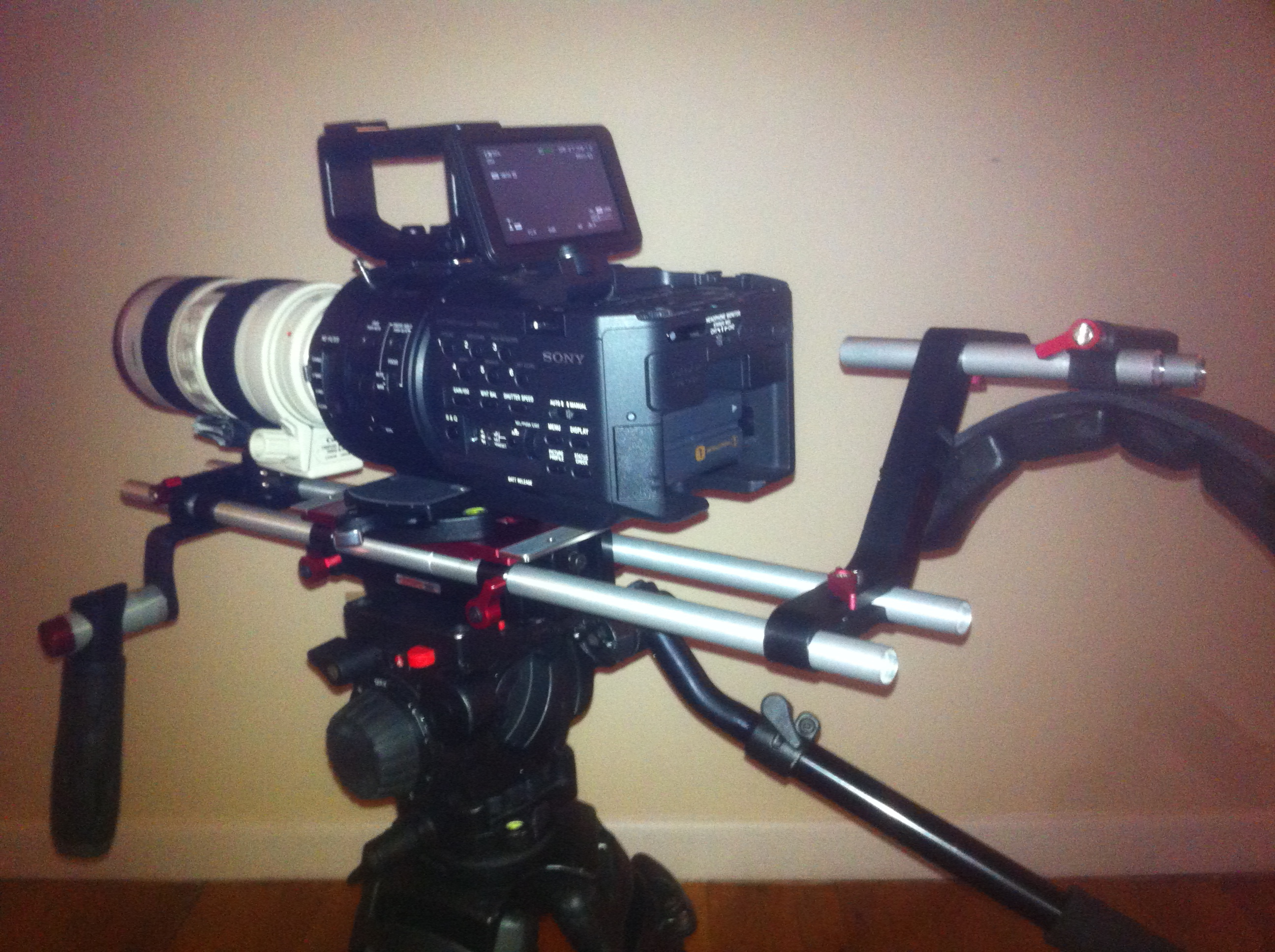

Here is the set up I ended up going with if anyone is interested.
Zacuto base plate and rods and Shape handles and shoulder pad.
I added a Vocas offset piece so the shoulder pad is offset to the right and the LCD is in front of my eyes. This way I can use the LCD with or without the loupe. It's not ideal, but it works. I can always add an EVF later if I want.
I also added a quick release plate to the base plate so I could easily pop the camera off if I want to set it on a table top, etc.
The shoulder pad and handles are easily removable if I just want to be on sticks.
It's definitely not as sexy as the Movcam rig, and definitely "bulkier". I wish I could have made the Movcam system work for me, but this does the job.
Also works with my 5D, which is nice.

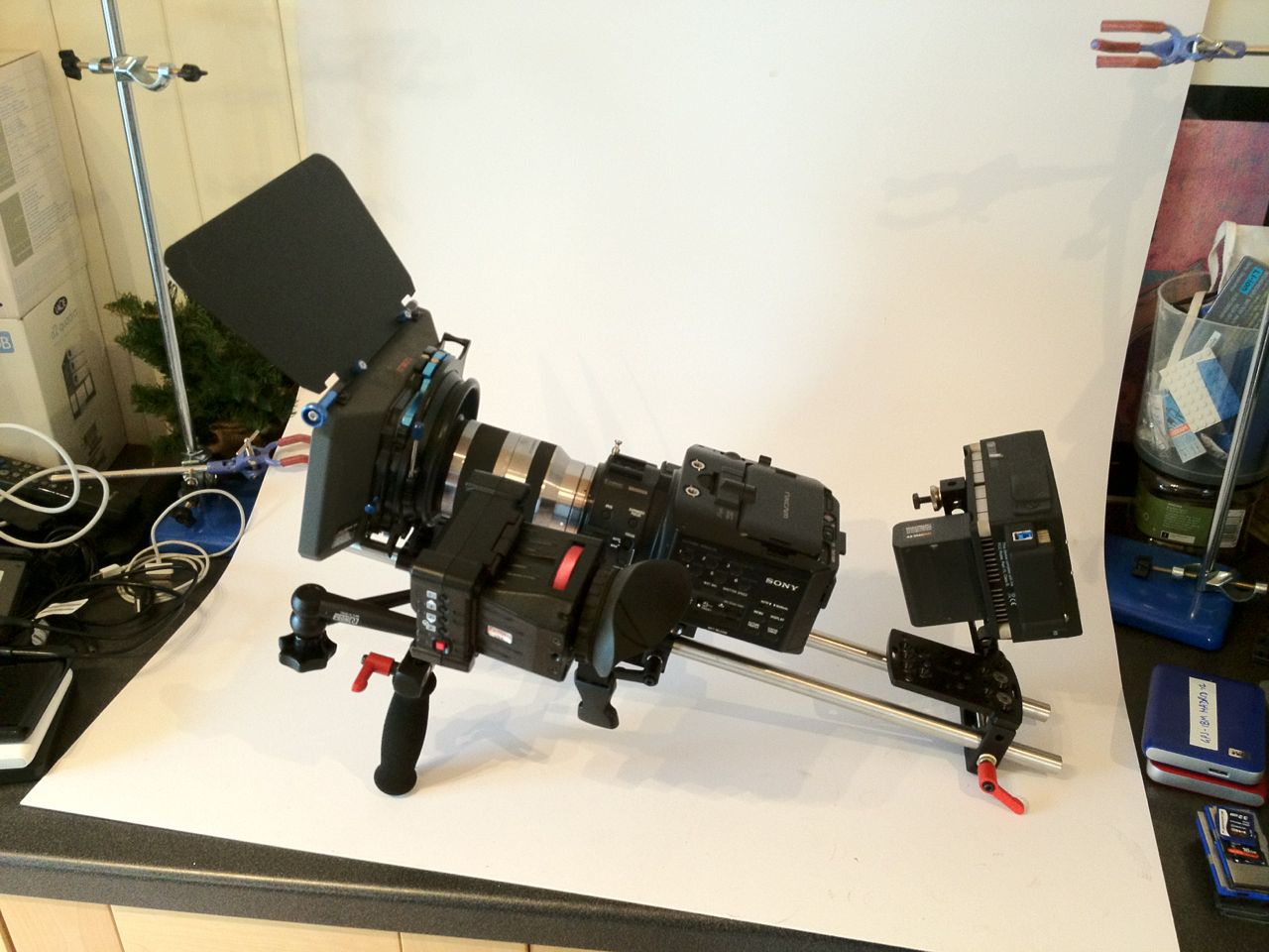

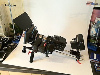

Definitely feeling your pain. I can see why this can become an all-consuming passion.
Having ascertained that:
- The kit you use is the kit you bring with you
- I like to travel fairly light
- I have GOT to have a rig I can put down safely
- I don't want to shift away from the Manfrotto 501 adaptor
I'm slowly coming to the conclusion that I'll probably go with a mish-mash of stuff:
- The front bit and 60cm rails from Half-Inch-Rails
- The Proteus baseplate from Cinevate to hold the camera
- The shoulder pad and bumper from HIR (basically rubber squidgy things)
- An HIR contraption at the back that can take an optional V-Lock and/or my PIX220
- My existing Noga Arm and Zacuto Z-finder up front
But, if I were starting afresh, I'd be going for the KinoTehnik evf (Kinotehnik - LCDVFE: Overview) perhaps - although it is a big SoB compared to the Zacuto, and the Zacuto is already in the camera bag.
The 3ality Technica Micron for FS700 Micron for Sony FS700 almost took my money - gorgeous, but it's another baseplate, and there's no rear counterbalance.
For all its simple, brutal, strong 'Isombard Kingdom Brunel' engineering, the HIR can be split into 3 bits, thrown in the tripod bag to live on hard tack and grog rather than being pampered with the camera and lenses, and the camera can either go straight to tripod, into HIR, or in the HIR, go in the tripod. And if I have to switch cameras (my EX1Rs or my DSLR), the rig can take it.
Trouble is, the HIR system is a bit of a Mechano parts bin experience at the moment. No one simple do-it-all solution, mainly because - as I found out - the world doesn't work that way. Pic below was a first try, PIX mount to be modified and there's no shoulder mount (or cabling) yet. Your mileage will vary!
