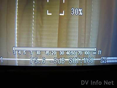

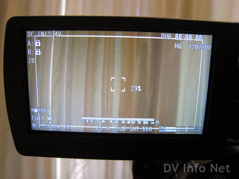

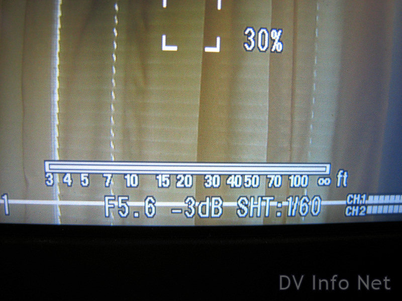

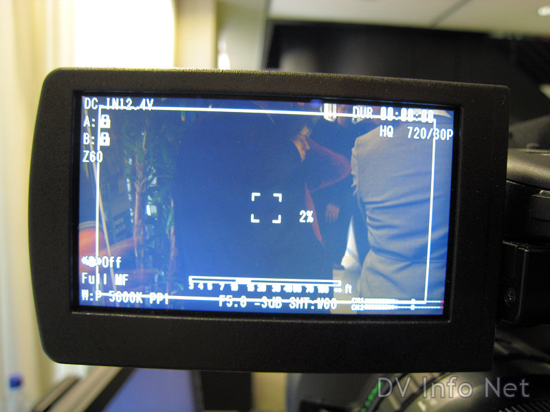

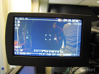

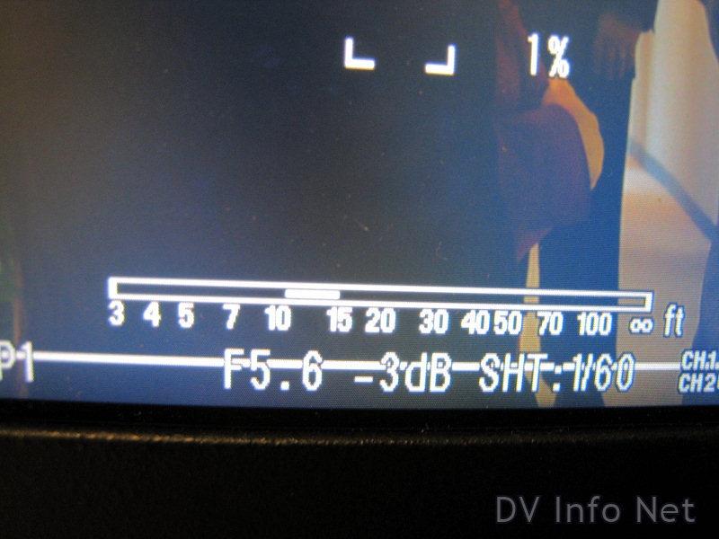

Here's a couple of snapshots which demonstrate how the Depth of Field gauge works in the EX1's viewfinder. It's selected as a menu item under Lens Info. Unlike some other display items, it's not sent over the outputs but appears only in the viewfinder and the flip-out LCD display. The gauge is dynamic and changes in real time as you make lens adjustments which affect depth of focus, such as focal length, exposure, distance to subject etc. The distance readout can be meters or feet. In my opinion it's a pretty handy feature to have. Click attached thumbnails to see these images large.

Of interest is how accurate the colors on the LCD appear vs. the real world through the lens of Chris' camera. It's like the LCD is a magnifying glass instead of a vf.
I'm referring to the lower left picture, BTW.

Top two shots show some glare by the way... the room lights bouncing off the LCD panel. I've been in that room before and it's difficult to shoot in there (Michael W. and Boyd can back me up on that). These are just quick and dirty snapshots from my Elph, a PowerShot SD800 IS.

I think I understand how it works, but how can the depth of field be different in each of those pictures if the aperture is the same at 5.6?

I was asking myself the same question, but then noticed it was zoomed differently (Z00 vs Z60).
