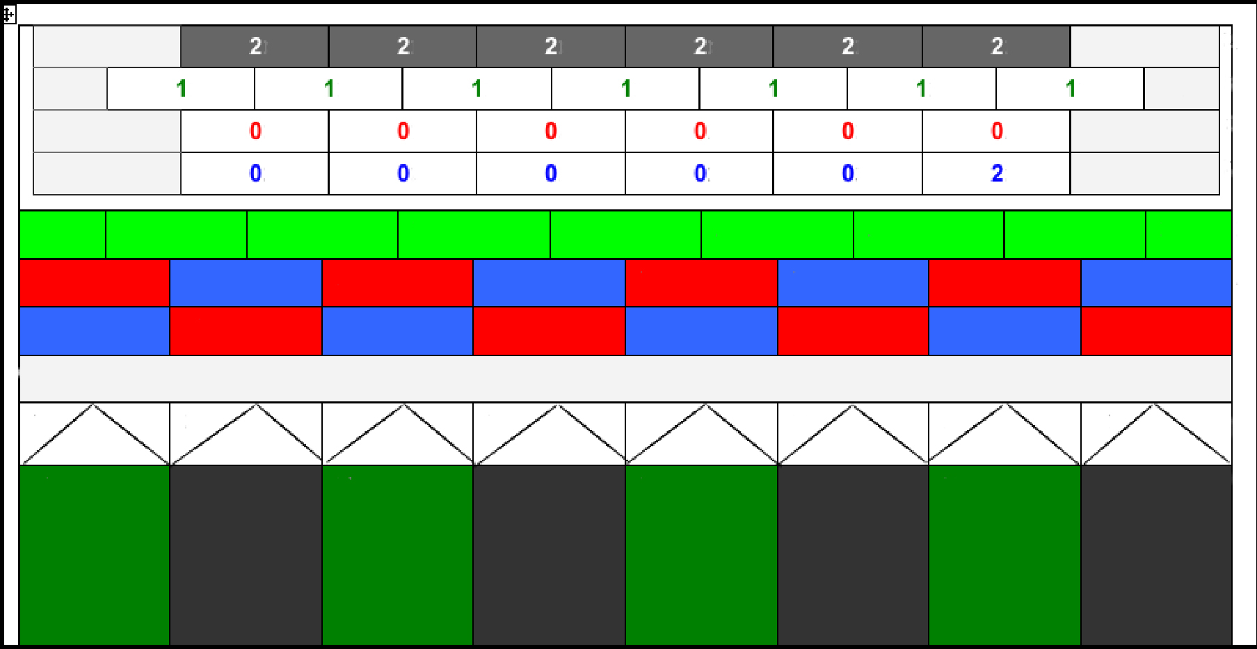

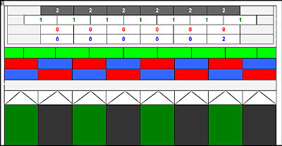

From my V1 book:
"By combining output from all three CCDs, both horizontal and vertical resolution is increased up to 150-percent on B&W static images. Naturally, that leads to the question of how real is the extra resolution obtained by using pixel-shift technology. The complex answer is that with pixel-shift technology, effective resolution is a function of the colors, the color patterns, and the motion of objects in a scene. The claimed increase of 1.5X is far too generous. The typical value is only 115-percent.
Therefore, while pixel-shift is a good solution, it is not as good as using higher resolution CCDs."
From my Z1 book: "The White and Black Fence (see the attached very crude diagram) has a luma signal that varies from 2 to 6: a range of 4 that indicates a maximum resolution—as shown in the Figure 5.1. A Green and Black Fence has a luma signal that is constant at 2; a range of zero that indicates resolution will be far more limited—as shown in the Figure 5.2."
Sony also adds an important addition to pixel shift:
"The 3 ClearVid CMOS Sensor system is different. It can
always produce maximum resolution, regardless of the
balance between colour elements, thanks to its unique
and sophisticated interpolation technology."
There is a critical difference between "passive" pixel shift (Canon and Panasonic) and "active" -- DSP-based 2D FIR -- interpolation of "pixel shifted" signals as provided by Sony. The V1's EIP chip does the interpolation. Other cameras that use "pixel shift" do not have an "EIP" interpolation chip.
