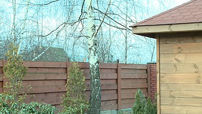

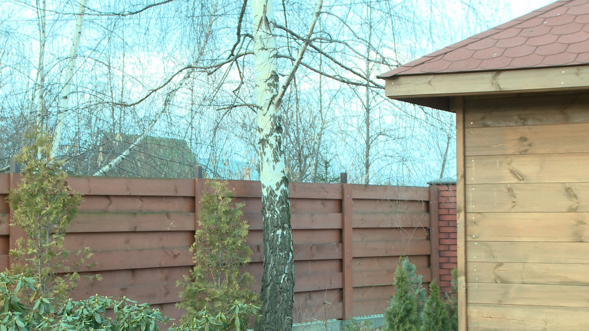

Originally Posted by Bill Ravens View Post
Here's my results:
Matrix---------------------on
Select---------------------hisat
Level...............................0
Phase..............................+6
R-G................................+75
R-B................................0
G-R................................-18
G-B................................-23
B-R................................-33
B-G................................+11
Color Correction..............off
White.............................off
Detail.............................on
Detail Level.....................0
Detail Freq......................0
Skintone.........................off
Knee..............................on
Auto knee......................on
Point.............................90
Slope............................0
Knee SAT level...............50
Gamma Level.................0
Select...........................STD3
Black............................-15
Black gamma.................-9
Low key sat..................0
It would be great to have someone validate my results. I'll redo more fine tuning as I go on. For the time being, my latitude is increased above the factory settings, my saturation is more lifelike. The histogram now displays a range from near 0 to 100%. Peaks are well distributed over the range without favoring lows or hi's.
I'd be glad to post some frame grabs if a server was available.
Time to go test in the real world.
I hope this helps out.

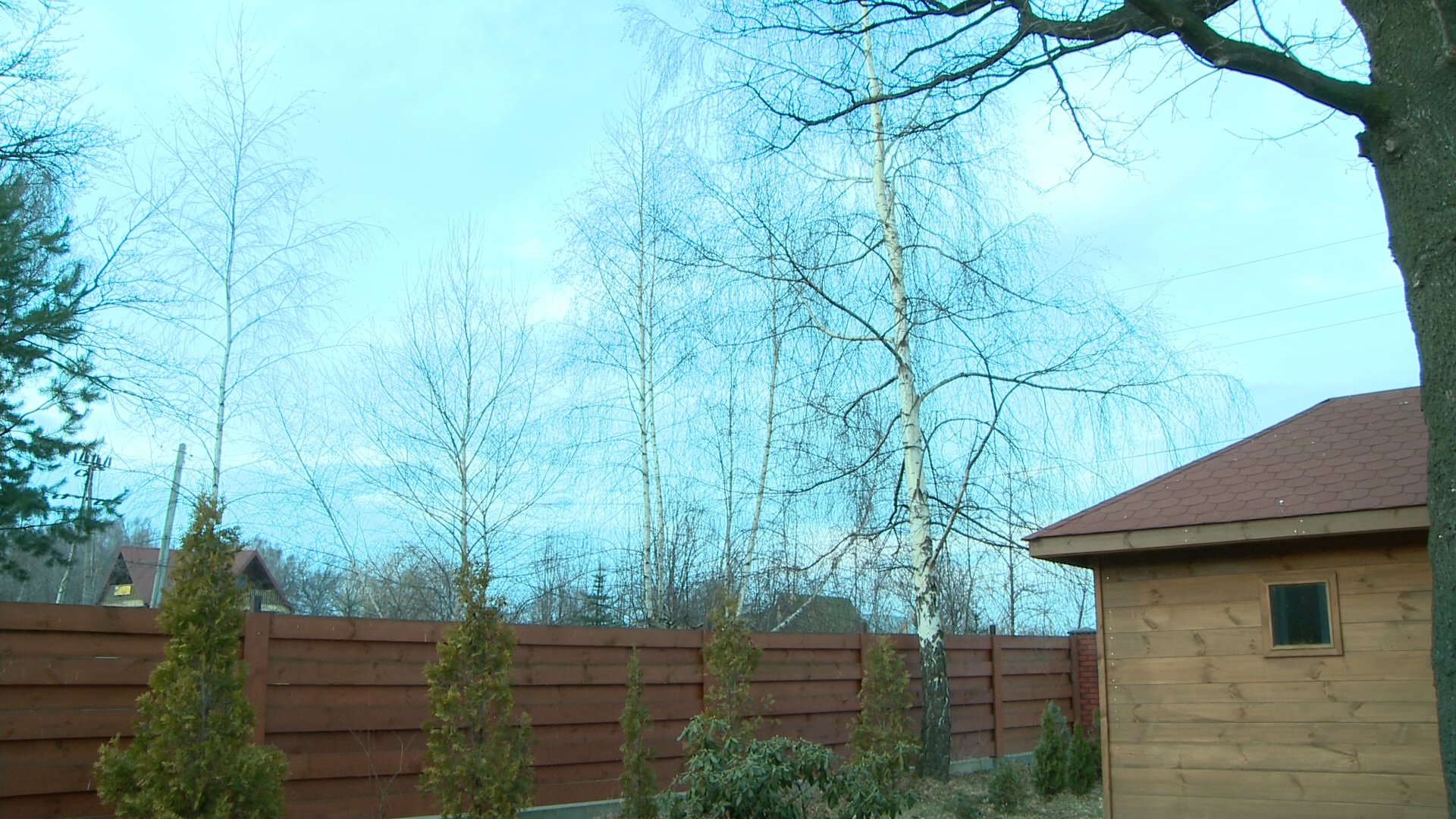

Well Bill, I created a PP with your above settings and did some test shootings, but am very disappointed with the result. Yes, the histogram now tends to evenly cover tha whole spectrum, but there is an ugly halo over the thin tree branches against the sky (which was just at the edge of 100% zebra appearing) - see attached grab. Also, there's too much blue in it (I was using some 5200K and auto-iris).
Now, could it be that with STD3, one should really alter the knee point, and/or saturation - slope? Or is something else at fault here that over-saturates of the near-clipping lights? The grab on the right shows more or less the same scene, but manually made a stop darker - the sky becomes more natural.
Can somebody recreate this, or is it just my camera? I'd appreciate somebody re-assuring me it's not my camera at falut, the STD3 being the widest but also the most standard setting!
PS: What's even worse is that at shooting time, nothing wrong was visible in the LCD... Just light blue sky, with small patches of zebra here and there.
Old February 4th, 2008, 11:24 AM   #132
Location: Palm Desert, California
Posts: 311
Yoyr problem is the STD3. i don't know how you got that quaote but Bill profiles were using Cine. I used Cine4 with Bill's settings and it was very good. Try that.

True...
I believe this is the latest from Bill.
Note. You may want to make 3 seperate profiles
using the three different CINE curves. (CINE1, CINE3, & CINE4).
This way you can choose the most appropricate one based on lighting conditions.
Matrix ...............on
Select................hisat
Level..................0
Phase.................-5
R-G...................75
R-B...................0
G-R...................-18
G-B...................-32
B-R...................-27
B-G...................13
Gamma Level.............. 0 (changed from -40)
Gamma Select.............(CINE1, CINE3, or CINE4)
Black..........................-12
Black Gamma..............0
Guys, I know it's the STD3 gamma that is causing it - I just wanted to check Bill's TrueColor settings using the default gamma curve, so I've used it on purpose. This is basically the default factory setting, with slightly modified Highsat matrix.
And this is why it worries me so much - instead of even better flat colour reproduction, I arrived at those ugly highlights...
Again, does the same happen to your cameras with the settings above AND the STD3 gamma curve?
Old February 4th, 2008, 12:57 PM   #135
Posts: 311
YES. All the STD gammas are bright and contrasty and generic looking. No need to ever use them.
