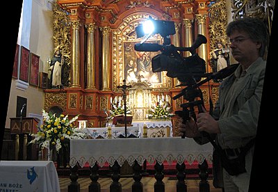

As to my "parameters" - I'm rather short (just 170 cm), and I guess I have proportionally long (or short?) hands. Please take a look at myself with my old rig (the PAG Orbitor); you can see how comfortably low my hands could be positioned. I'd very much like the same with the microShoulderMount, with the camera, microMatteBox and microPod higher and backwards on my shoulder. So, does it call for the 12" grip rods, or will the 9" suffice?
