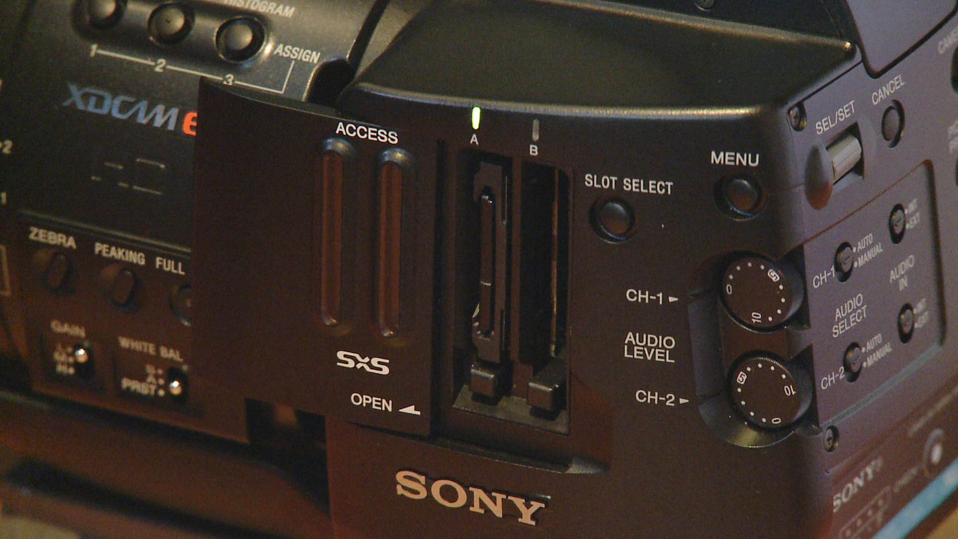

The Sony EX1/EX3 camcorders use special SxS cards, which are very fast, to allow HD video recording at regular and overcranked speeds. If you don't need full range of overcranking that SxS cards provide (and you rarely will), there is a way to pay about 10 times less for the same hour of quality HD video recording, by using an adapter with certain SDHC cards instead of SxS. Your camera's software, and your hardware have to be compatible however.

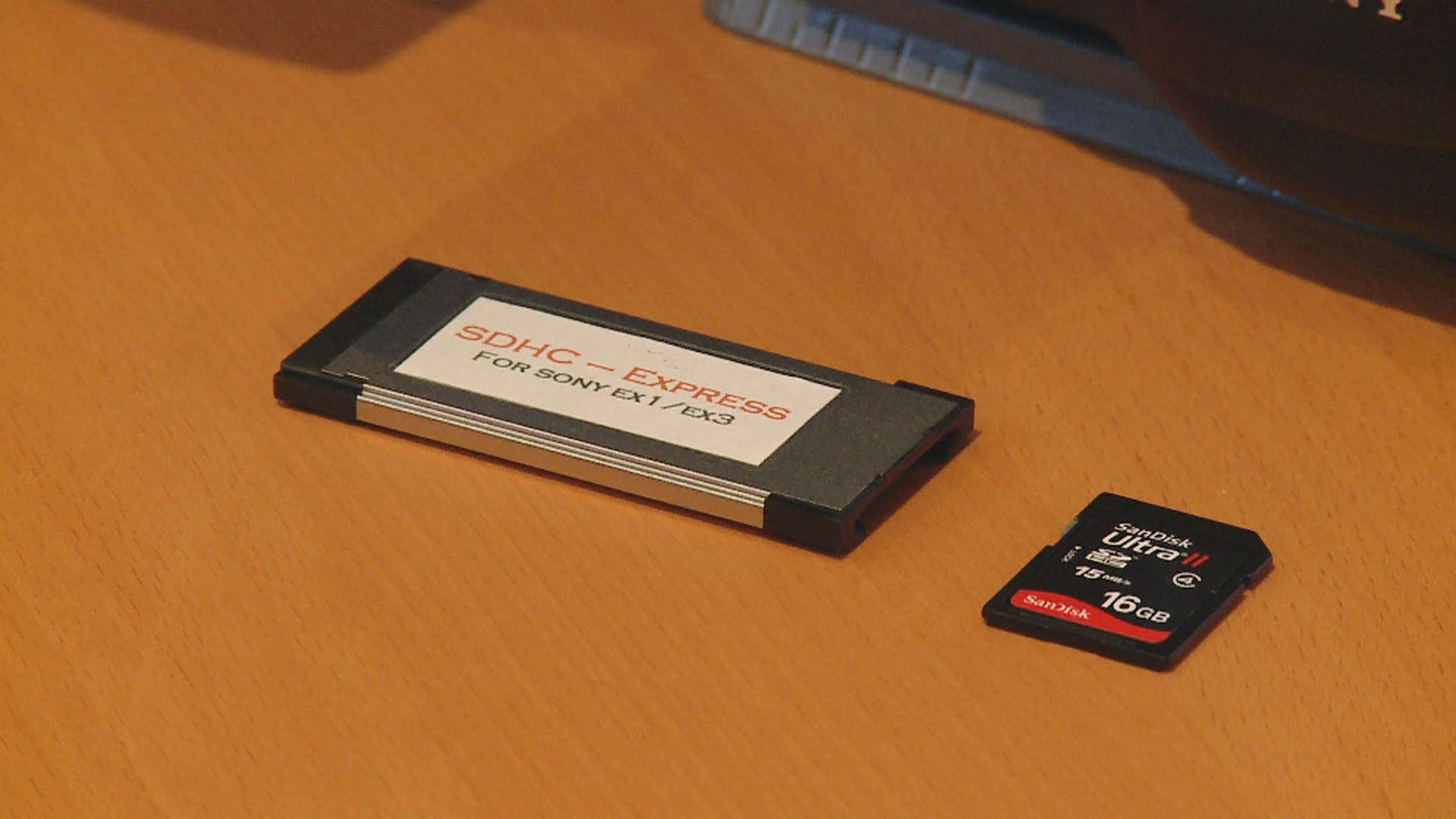

MxR Expresscard is born!
I received the final production version of the Expresscard adapter I was referring to in my post of 28/11/08.
This isn't a prototype, this is from the first batch off the production line, ( although we didn't have the final artwork ready for this small batch, so please excuse the temp label for now ).
If you watch the video below you can see the card in action.

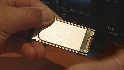

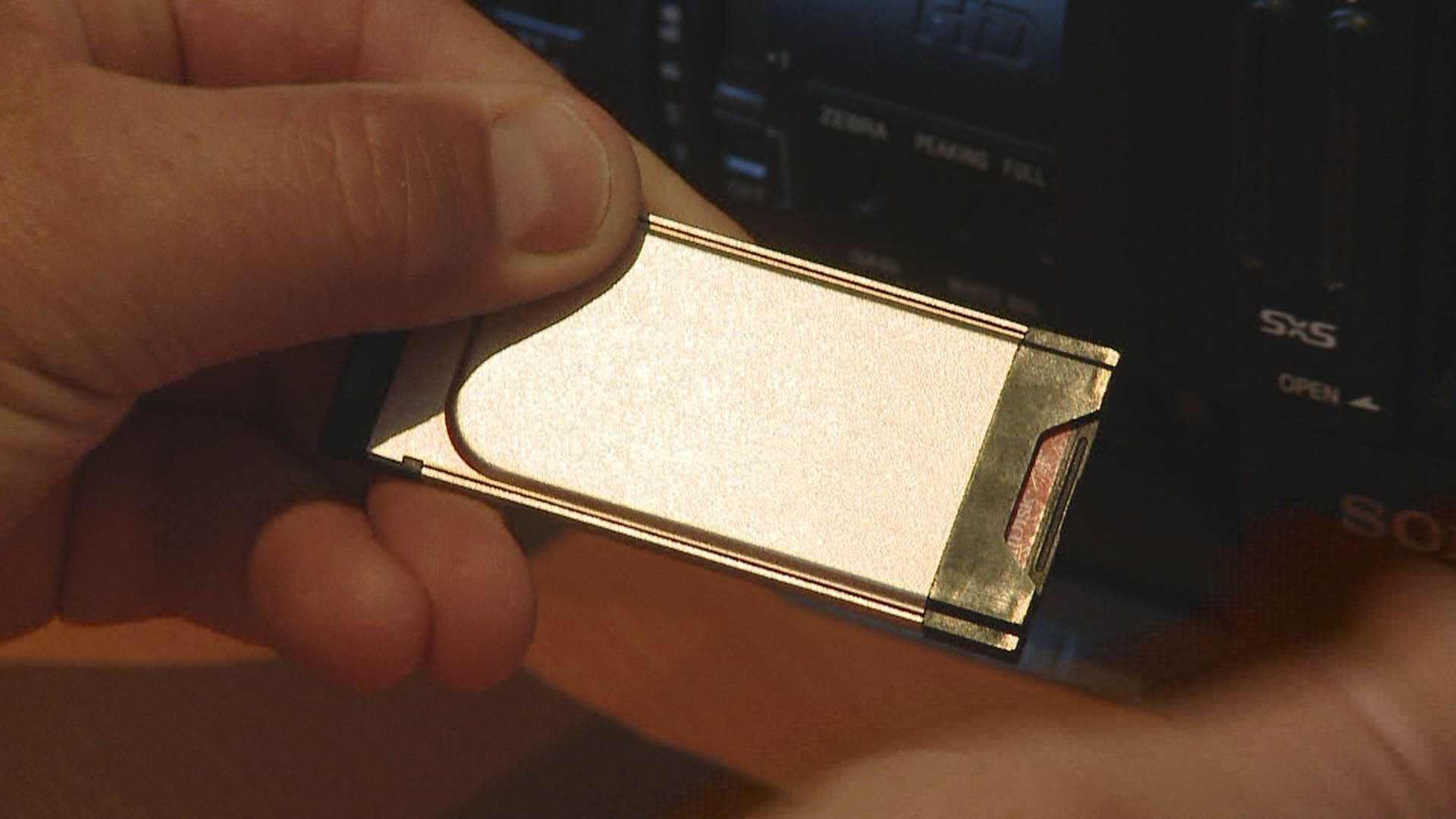

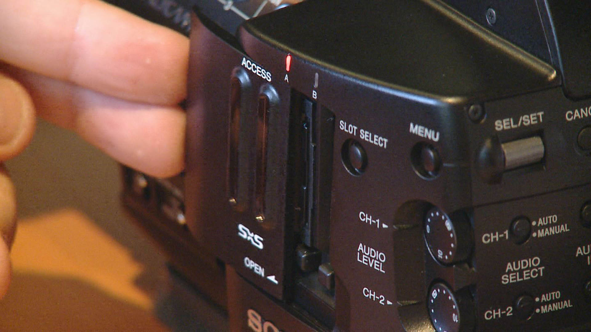

The first design consideration was to ensure that with an SDHC inserted, the EX1 door would close. - Done.
The second was It is designed to ensure that the SDHC will not eject from the Expresscard while it is in the camera, unless by deliberate and concerted effort by the user, not by accident. You can see where it slightly moves but does not eject or disengage from the Expresscard or camera, even after sticking my big thumbs in there to try to. - Done.
The third was performance - that it should meet at least the performance of what other cards were already doing. The card will crank up to 48fps, which as we understand from many on this thread is the limitation of the USB implementation on this camera. - Done.
The fourth was that it would be reliable, that it should work each time and every time. So far it has been recognised every time by several EX1 cameras and hasn't dropped one frame. - Done.
The last consideration, not a design one but just as important, that it didn't cost any more than other cards already on the market. - Done.
The price? $US35 + postage which will be approx $10 to the US, and $12 for Europe.
