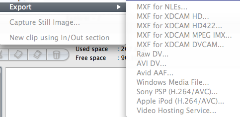

The EX3 files are HD and different from Standard XDcam.
They can be easily converted using clip browser, see attached screen shot.
Exported to what? which of these do I use as I am not a editor and this is all new to me.

We will edit on the laptop..then transfer the edited package back to the F350, then take the camera up to the sat truck to feed out....so when I hand the editor my video I want him able to edit right on the spot...so it sounds like I shoot it HD, use the clip browser program to convert the HD to a MFX XDCAM DVCAM files and dump it all on a 8 GB flash drive or 160 GB hard drive to had off...does this sound right to you all?

Set both the EX and F350 to shoot HD using the SP mode. That way both cameras will shoot 1440x1080i at the same bit rate (25Mbps) with the same colour space. Depending on the edit application you may need to use the sony clip browser to convert the EX files to "MXF for NLE" but more and more edit applications will support both MXF and the EX MP4's without this step. Then edit using a project set to match the F350 (or even HDV as this is what you will in effect be using). Then export the finished cut back to the F350 as 1440x1080 25Mbps CBR XDCAM HD and play out from the camera using the built in SD downconverter to give an SD output.
This should be a fast an efficient workflow as all the footage will be 1440x1080 25Mbps CBR XDCAM. There will be no need to transcode anything and the only things that would need rendering would be any captions or effects.
