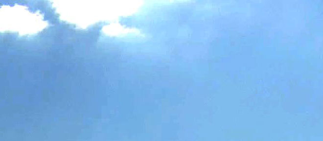

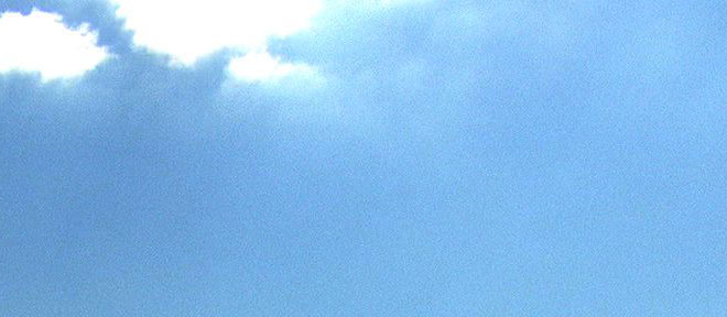

Attached are a couple of sections of frame grabs from some EX1 and NanoFlash footage that has had a heavy grade applied. The difference is very clear. For a more detailed review of the quality and further frame grabs take a look at my review:
XDCAM-USER.com Convergent Design NanoFlash Review Part 2 – Picture Quality
Before anyone complains that the frame grabs are different sized files I will say that these are good representations of what I saw on my monitor and they were compressed at the same compression ratio. This shows just how much more detail is being retained in the 100Mb/s footage.
Convergent design nanodrive for post work-sky-35mbps.jpg   Convergent design nanodrive for post work-sky-100mbps.jpg

Looking at those 2 grabs, I've been wondering: yes, the 35Mbps version has a lot of blockiness to it, but IMHO, the NanoFlash 100 Mbps is not clean either - instead of being blocky, it's very grainy.
Alister, could you comment, please?
Old August 31st, 2009, 12:14 PM   #53
Posts: 4,957
Piotr: Do remember that the grabs are from graded footage, one of the results of the heavy grade was to increase the appearance of any noise. The noise is coming from the camera. At 35mb/s the codec is running flat out, as a result the codec tries to save bandwidth by smoothing out the noise which results in the blockyness. At 100Mb/s the codec has enough head room to be able to accurately record the noise so there is no need to do any bandwidth reduction.
When you watch the actual video clips you can see a direct correlation between the noise and the macroblocking. This indicates that the noise is from the camera, not the NanoFlash and it is a very good example of the difference 100Mb/s makes over 35Mb/s.
