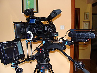

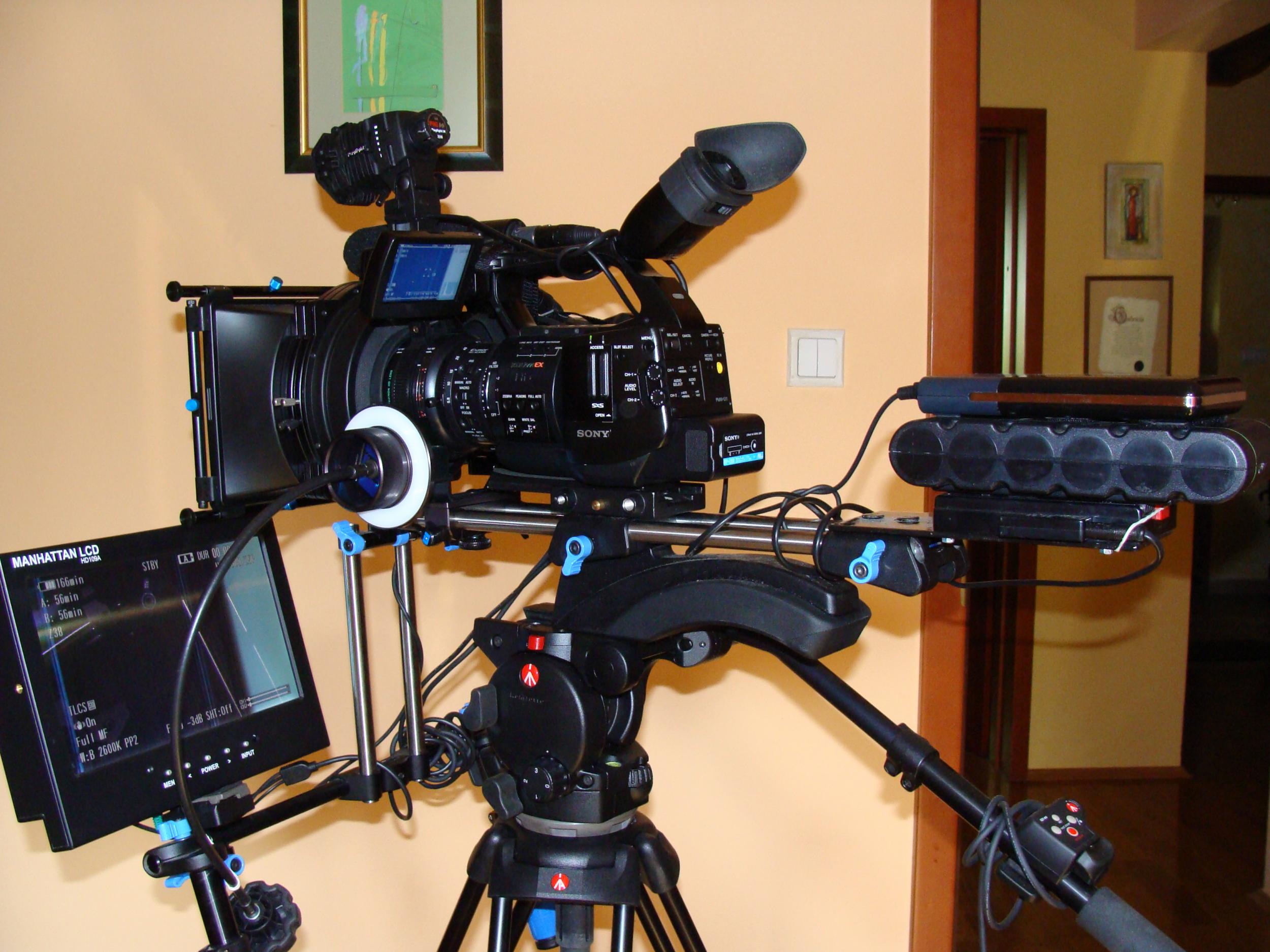

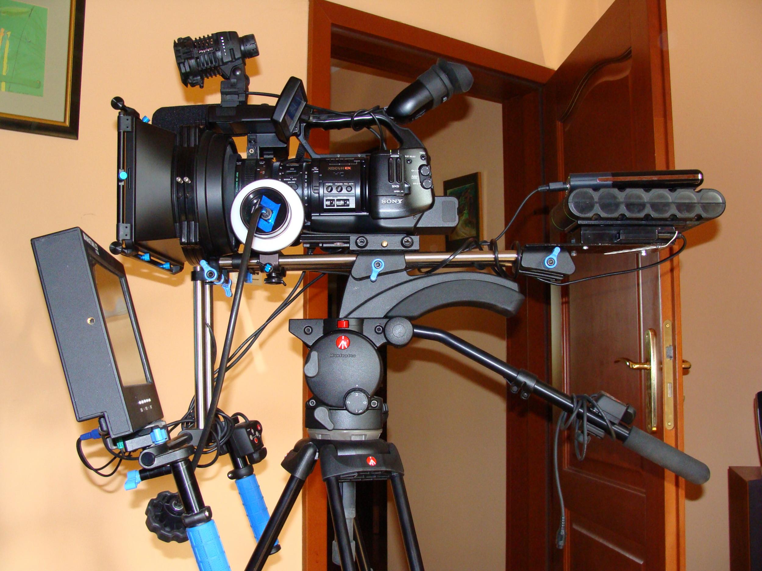

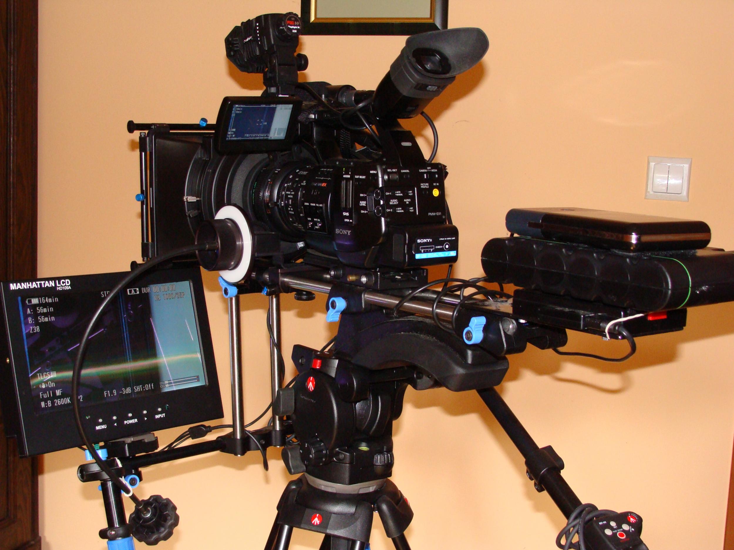

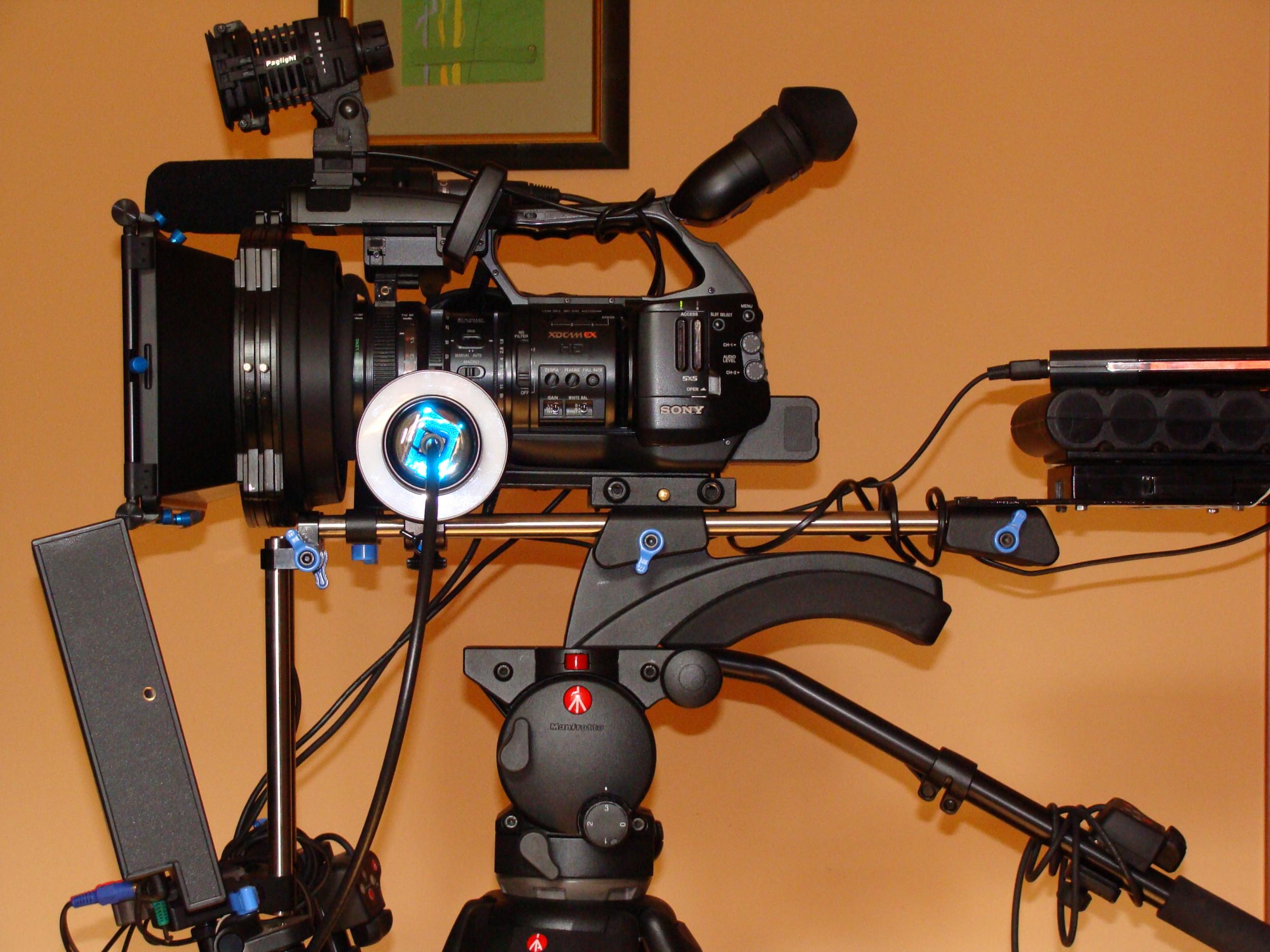

Bob is correct. As promised, 4 pics of my RR shoulder mount as is, after a long time trial & error testing. As you can see, the camera is almost on top of my shoulder (check its position relative to the shoulder pad). With the matte box and monitor, it's still front heavy (even with considerable counterbalance from the PAG battery, Tekkeon monitor battery, and soon to come NanoFlash on top of them). Not to mention my Letus between the camera and the matte box...
Judging from the relative position of the LCD and the shoulder pad, and using your imagination on where my head/eye would be - can anyone advise whether or not the Hoodman Loupe would fit? I guess it wouldn't - even though I wish it would, thus making the rig free of the monitor (which is now obligatory).
The Manhattan 10.9" HD monitor is great when on the tripod, but not with this shoulder mount arrangement!
Best shoulder mount have used for ex1/3-dsc01444.jpg   Best shoulder mount have used for ex1/3-dsc01445.jpg
Best shoulder mount have used for ex1/3-dsc01450.jpg   Best shoulder mount have used for ex1/3-dsc01451.jpg

So much for keeping the EX camera as a portable system, it woulddn't look out of place as the alien space ship in a Star Wars movie.

Good Lord Pitor!! How much does all of that weigh?
In answer to your question (and after my test - which did not come close to reporoducing the actual height of the camera with your system) - there is no way the HoodLoupe will work - just too great a distance and tilt.

So I thought, Barry :)
But I'm still considering the HoodLoupe for my naked-camera, hand-held shootng!
PS. The rig depicted IS heavy, but quite well balanced and actually working...

Piotr, what kind of shoot do you use a rig like that on? If your going to lug that lot around you'd be better off with a stedicam type device.

I agree, Alister. I must admit that if I knew the LCD is useless on this kind of a shoulder mount, and a monitor is essential - I'd think twice before buying the RR shoulder mount (even though it's a very well made, and highly configurable system). I'd also buy a much smaller monitor...
Anyway, to answer your question: 90% of my work is done with a tripod anyway (I do live classic music concerts). It happens quite often that I do an ad-hoc interview with the artist right after recording his performance; those people are usually very busy, and in a hurry - so when there's no chance of a more controlled arrangement, I grab the rig as depicted and do a "standing" short interview. For up to half an hour, no problem for me - and much steadier picture than hand-holding a naked camera! Plus I've got a small fill light, a shotgun, and a matte box for filters as needed (still waiting for the promised IR one from Tiffen, though),
