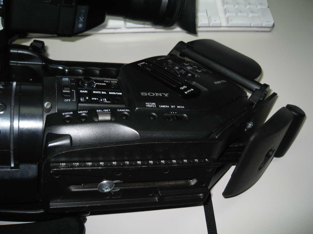

Yeah Bob, I'm heading that way too. Every shoulder mount I look at seems to have something I do not like. Then there's the price. I'm still in the design stage but thinking of incorporating detachable rails into my baseplate design.
Here's my baseplate I knocked out one morning. The hardest part was finding the aluminum, but I found a piece in my shop. Total out of pocket might have been $1.50 for two longer metric screws that I did not have in my bins.
Best shoulder mount have used for ex1/3-img_0064.jpg
Kevin Spahr is offline   Reply With Quote
