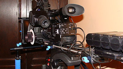

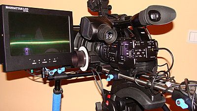

I'm very happy with my HD109A monitor, powered from a Tekkeon battery, when using the tripod, and I'm going to keep it.
However, I need advise on which of the 2 new upcoming Manhattan models (the HD071A or HD8900) I should pick to mount on the left handle of my RedRock shoulder mount, as depicted below with and without my current HD109A (too big as you can see)...
The HD071A would fit better and handle easier with this rig, while the HD8900 would certainly give me a better picture to focus on. Tough choice!
Comments welcome

Posts: 382
Piotr,
I haven't been able to shoot at all for a couple of months because of a pinched nerve in my neck. This didn't happen overnight.
I would suggest the lighter version. I also find that reading glasses help a lot for critical focusing and they are very inexpensive.
Comments welcome
