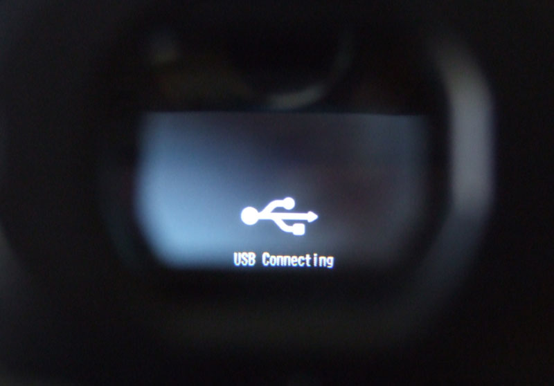

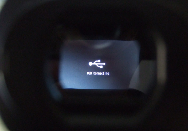

Hello,
some weeks after getting my EX1 I discovered a brownish shaddow in my viewfinder. Its not visible on display or recorded on footage. It is definetly somewhere in the upper part of vf/the glasses, because one can move the head/eye and the shaddow will slide away. I never use viewfinder (film at night on tripod only) so I almost never look into it - that's why I noticed it so late.
The shaddow is clearly visible when connected to USB or in thumbnail menu (black background), but it is (almost?!) not visible when filming.
Is this somehow normal and if not, what caused it? Will changing the vf-glass remove it? For what costs I should prepare when changing the glass/vf?
I myself do not care about it, but I will sell EX1 for EX1R and fear the questions of the new owner...
Thanks a lot,
attached two photos to show the shaddow and the different positions at a different views.
EX1: Brownish shaddow in viewfinder-vf1.jpg   EX1: Brownish shaddow in viewfinder-vf2.jpg

If it moves relative to the screen as you change viewing angle then it's in/on the optics. Probably just dirt.

Thanks Alister.
Yes, I assume its not a big thing, but its no dirt one could wipe away from outside. So it seems to be something in the optics glass or between different glasses in vf. The strange thing is, that its a "optically bend" shaddow, somehow the shape like a rainbow beam - its no "blob" of dirt.
I will check manual if one can take viewfinder off and polish all sides of glass.

So you think the sun hit the viewfinder from above, not through the electronics? I didn't even know that this could cause any problems. So I will put black tape on the viewfinder since for my applications I never need it, just the LCD screen.
It looks like some kind of transparent brownish rainbow. So nothing to really "feel". Its inside the tube, not on the outer VF-lense, not on the VF-LCD-Screen, its somewhere on the lenses inside of the VF and I can see no sharp corners, no meltings, no droplets. Its somehow ghosty. Its obvious when USB is connected or the machine is in thumbnail player modus (black backgrounds) but it really seems not to be visible when camera is on at normal daylight.
So, can I "open" the tube for cleaning?

I have the same issue on my EX1, but I don't believe it's because of the sun burning the lens. It's really only visible when the LCD is displaying black, which leads me to believe it might be a LCD viewing angle issue. It's probably curved because one of the lens elements is probably curved, too.
Can anyone else close down their aperture completely and see if they also see the brown streak?
