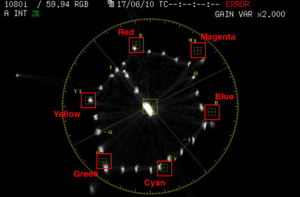

Well, this has nothing to do with dialing out the green on the camera LCD, but I'll bite.
What you're asking is pretty easy. It's kinda the point of the DSC charts. The simple DSC charts have 6 colors (Red, Green Blue, Cyan, Magenta, Yellow) and the task is to use the camera's matrix menu settings to get the 6 dots the chart will create on the vectorscope to land within the targets for those colors on the vectorscope's reticule. You use the R-G, R-B, G-R, etc etc matrix items to do this.
The DSC 12 color charts go a step further, and create dots BETWEEN the 6 major targets, so you can see what the camera is doing for the finer shades along the way.
I am trying to get my hands on a DSC 12 color chart so I can straighten out the stock Sony matrix setting, which I am not a fan of. I also want to get said chart in front of an Arri Alexa, so I can match the F3 to the Alexa in Rec709 mode and get it on as a B camera on Alexa jobs, which there are a metric crap ton of in my area. I'd buy one, but it's a little hard to swallow $380 dollars for something I'll use for one day.(the small, front box 12+4 ChromaDuMonde is $380ish). You can get cheaper if you can live with the base 6 colors.
For extra credit, once I get a stock F3 aligned to the Alexa, I want to create a LUT to use in post to match Sony S-Log material to Alexa LogC material, after that LogC LUT has been applied. No end to what I will do to generate rentals, I guess :-).
Below is an pic Ben Cain (Negative Spaces - Ben Cain) made of a 24-color ChromaDuMonde chart, attempting to straighten out a Canon 5D. This might have been the "Faithful" picture style, although I do not know if he was using live camera output, or files, or what.
By the way, those 4 dots at approximately 11 o'clock reaching in towards the center are the extra skin tone patches some of the DSC charts have. They are supposed to align to the "I-Bar", which is the vector on the vectorscope skin tones are arguably supposed to land on if everything is copasetic.
