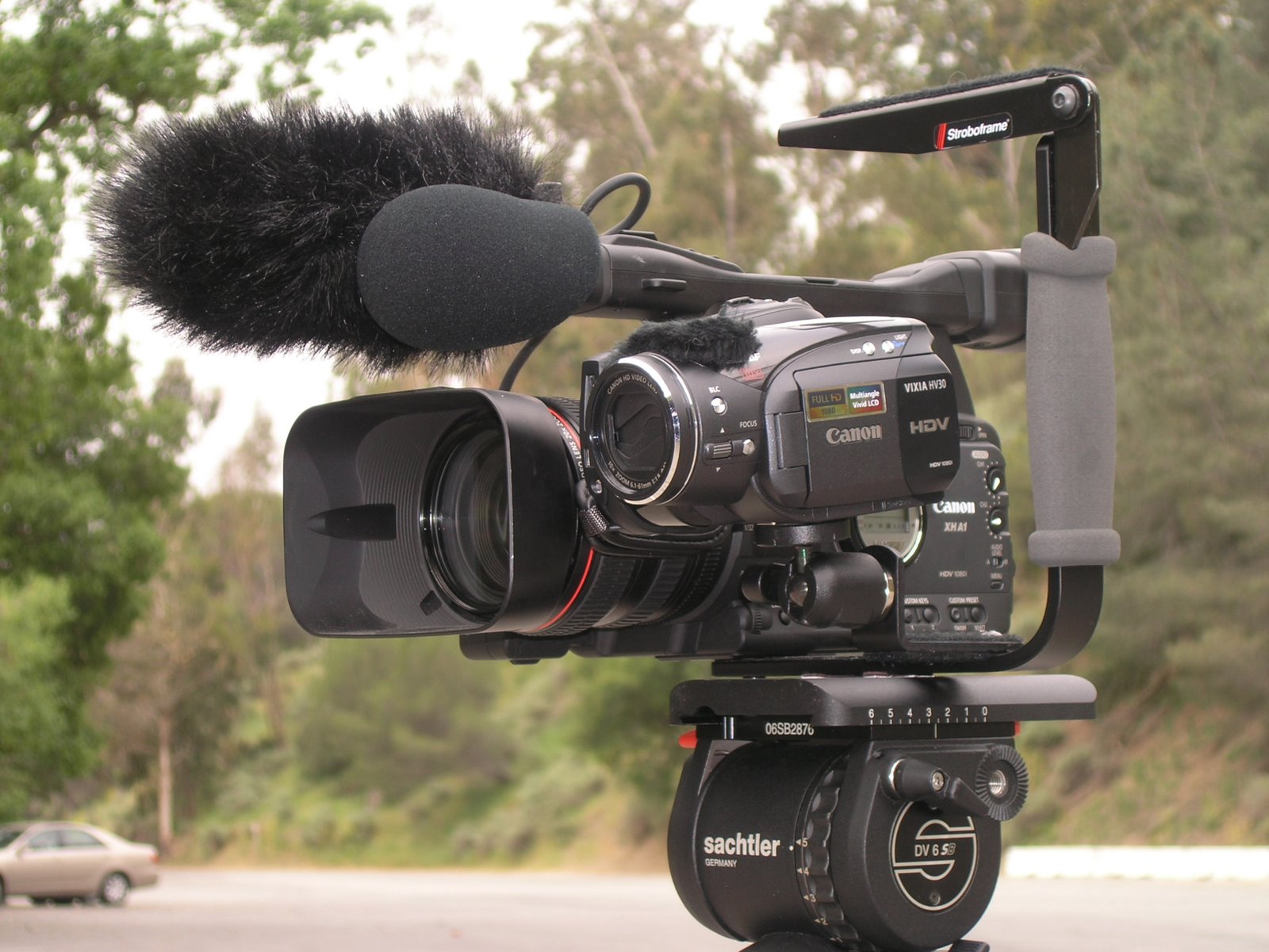

I'll save you a bit of $ with a DIY rig I used to to a test compro. It involved a Stroboframe Quick-Flip bracket, a small Bogen ball-head and an L-bracket I had laying around. DIY to the rescue. You can mount the 2nd camera almost anywhere on the bracket, but I wanted the lenses to be as close as possible (while still accessing all the buttons of each camera. Therefore, the 2nd mini-ball head was necessary. Otherwise, you can plop one camera on top of the bracket using a 1/4 screw.
Tripod/Head for dual video cameras-double-cam-rig.jpg

Wow... I am impressed. I have been searching the net for quite a while and have yet to find a commercial solution to my problem... Thanks Chris for that link to Hague Camera Supports.
Oren, I like that DIY solution you have come up with. I have copied the picture and I am going to hit the camera stores this week and see if I can make your solution work for the two cameras I am going to use for taping our football games.
