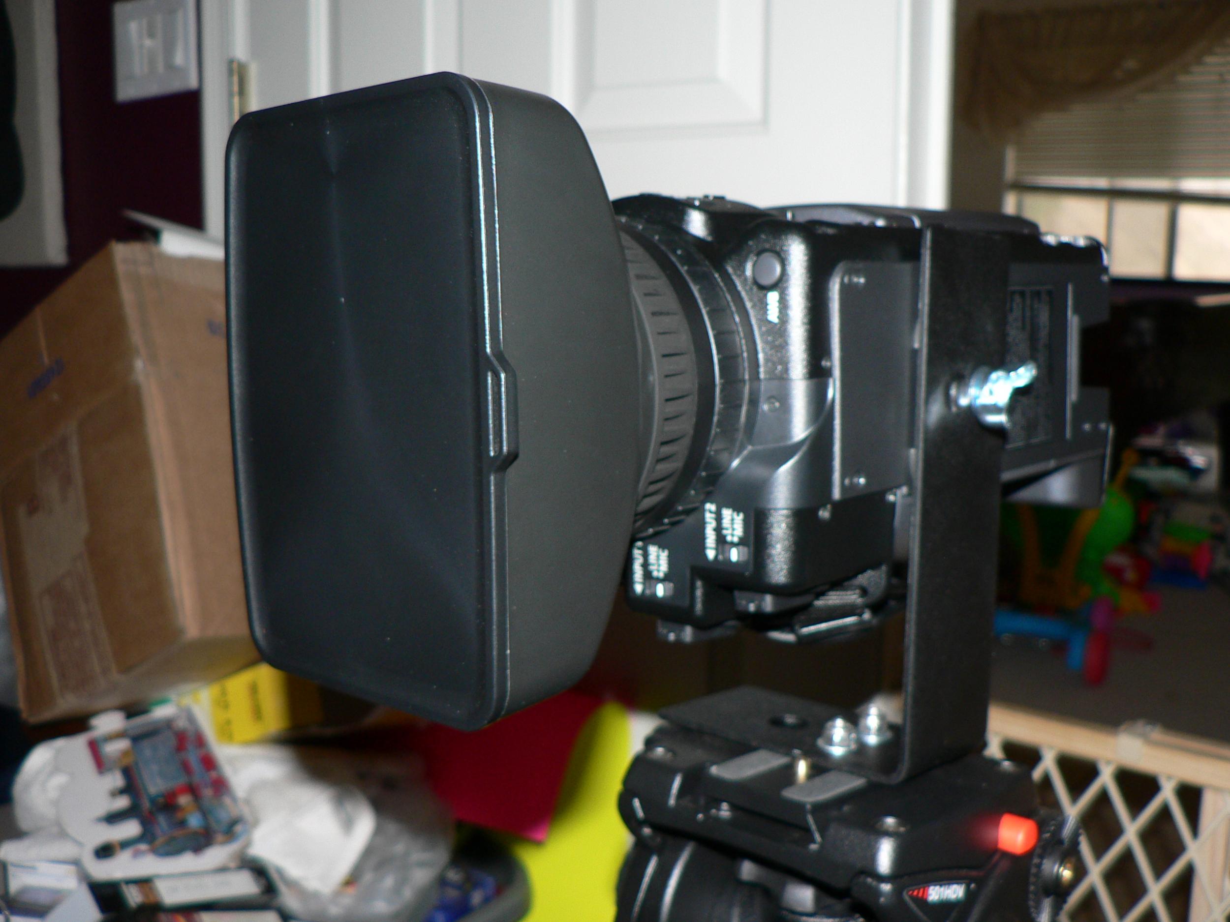

I'm going to have a machinist friend of mine make an L bracket. true 90deg and shake won't be an issue as we're using 1/4" steel...will keep weight down by drilling some lightening holes. Still mulling over the design but I think we're just going to weld a quick release plate to the bottom and the female side to where the camera goes. I'll post it when done.

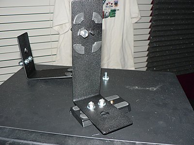

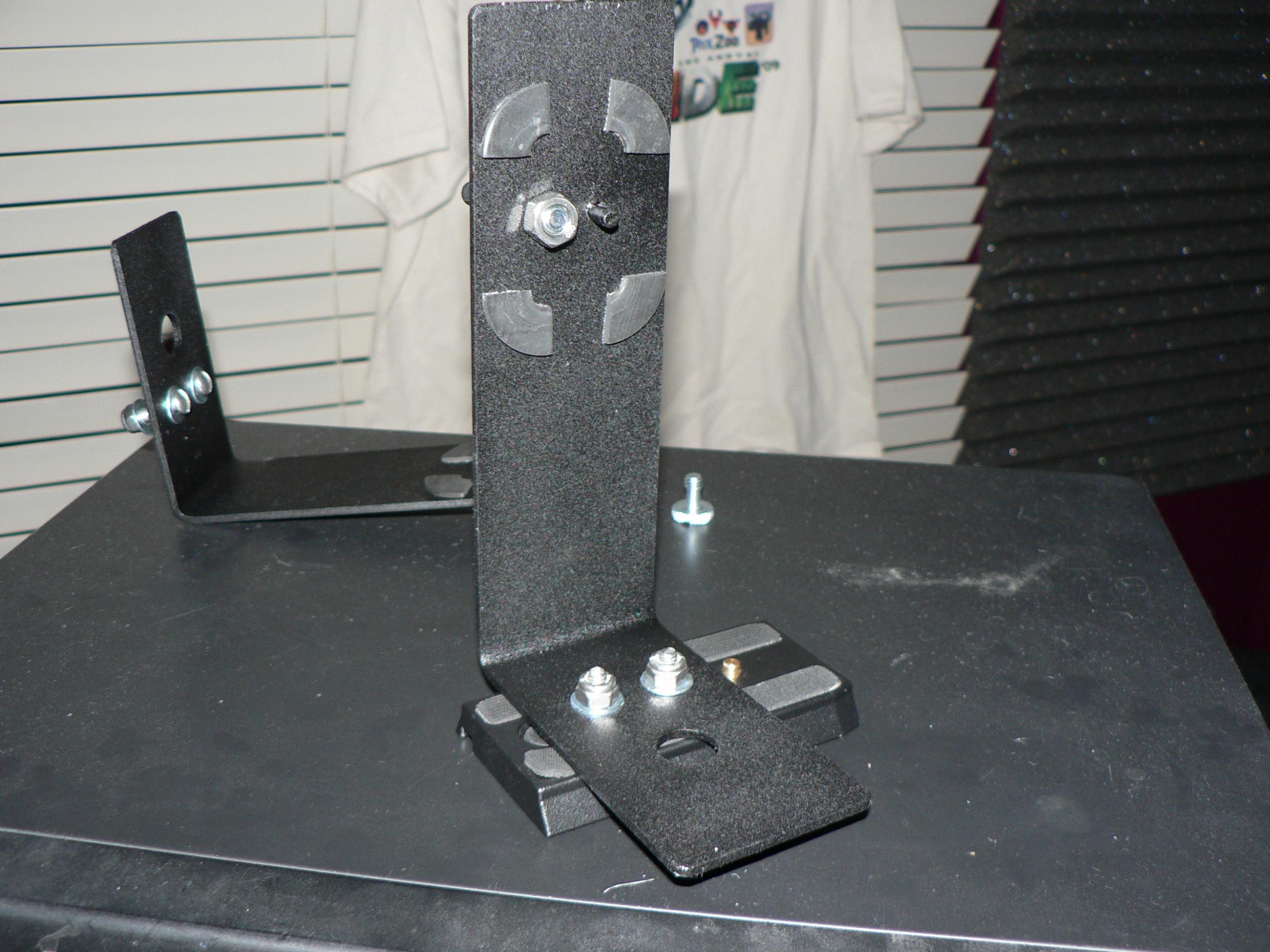

So here's the update...machinist friend not needed...Home Depot run today found strapping metal for house framing in 2" wide already bent into a perfect L. It's about an 1/8" thick and even held in my heavy vise I couldn't bend it using all my weight. Bottom is about 4" and top is about 8". Cut about 2" off the upper and smoothed the edges. Got 1/4-20 nuts and bolts (pair) to mount the QR plate for my Manfrotto and the upper will get a 1/4-20 thumbscrew for the camera and a smaller bolt brazed to the bracket for the stabilizer pin. Once assembled, it'll get a coat of primer and black paint and total cost will be $27 for a pair (friend wants one too) with all hardware and paint! I'll post link to pics with and without camera as soon as it's done. |

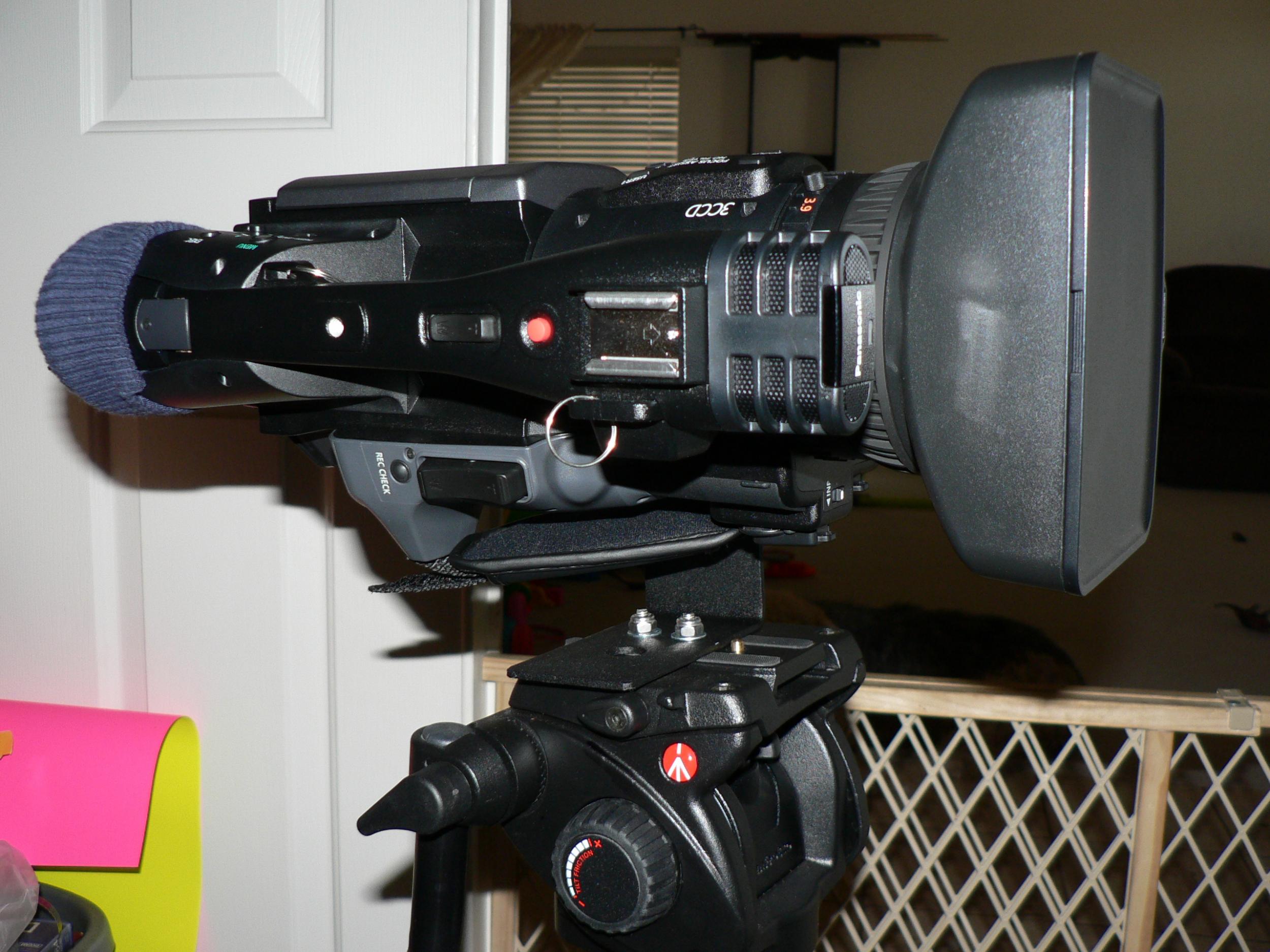

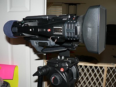

Here's the finished. It's not the prettiest but not too bad (I'm not great at brazing!) CHEAP and functional! Still allows full use of the tripod and when I need to mount to a teleprompter for greenscreen work, it'll work just fine! Last edited by Robert Turchick; November 11th, 2009 at 04:05 PM. |
