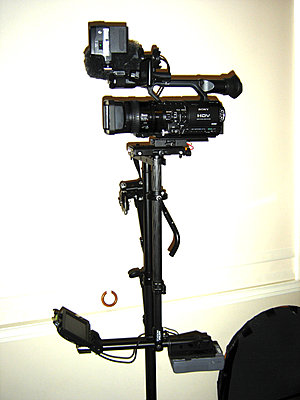

I’ve been setting up my Pilot with 8.5 pounds of gear, plus an Anton Bauer battery (almost 2 pounds) and I still have a small amount of lifting range remaining. Are all the silver weights removed from your rig? Can you post a picture of your set up?

Thanks carl. Battery used is a Swit 8080S - 1.85 pounds. Total camera weight including quick release and silver weights is 8.02 pounds. This is the most that the arm will hold without hanging down.

Hi Carl, your carrying a heavier load than me. I will contact Tiffen.
