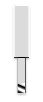

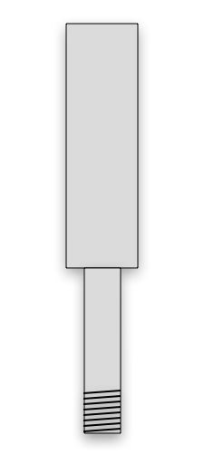

I have a rubber grip that I slid off the end of a tripod handle on the merlin's bent post right now and the GC's handle fits perfectly over it, but for the final version I picture a piston of solid aluminum with a narrower section at the bottom that fits into the post holes with a threaded end for a washer and a nut. The top section would be the diameter needed for the GC handle and, being wider, would act as a stop, resting on the top of the post holder. Once we get it right it should be easy to run off a bunch of them.

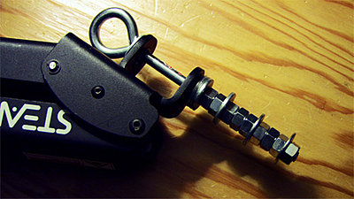

Hi Randy,
I took the budget route. Works just fine.
http://www.dvinfo.net/conf/attachmen...1&d=1234592159
Joel Peregrine is online now   Reply With Quote

Its very easy to remove and if you have a larger washer at the bottom of the stack the glidecam won't scratch the steadicam's post holder. There is just a screw on the bottom of the post and a washer in a slot that keeps it from going down. I put this together to give my father in law an idea of what I was looking for - he was going to help me machine a 'real' post, which I didn't end up needing:
GLIDECAM_STEADICAM
