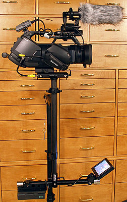

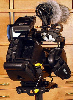

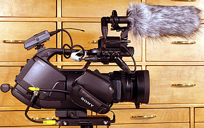

EX3 on Pilot no problem
As with 35mm film professional Steadicam setups, you need to remove the unnessary stuff from the camera to make it work. Also, use the Pilot IDX battery to power the EX3. I used this cable:
Vortex Media: VIDEO & PHOTO Tools and Training
and put a 2.1mm cable on the end. Click on pictures to enlarge.
By the way, I've also added a wireless video transmitter to this setup. The only change was to replace the 2 middle weights on each end of the bottom with 1 middle weight and 1 of the smaller round end weights.
Steadicam Pilot too light, can that be helped?-ex3_1s.jpg   Steadicam Pilot too light, can that be helped?-ex3_2s.jpg

The Sony EX1 and EX3 both have a connector that allows you to use an external source to power the camera. So the idea is to remove the EX1/EX3 battery, and wire a connection between the external power source and the camera. Click on this link for an example:
If you have the Pilot version with the IDX E-7S batteries, this will power the EX3 and Pilot monitor for many hours. If you have the Pilot with the AA batteries, using that to power the EX3 probably won't work too well.
So if you have the IDX batts, the idea is to get that power to the camera. The Pilot has an internal power cable running from the bottom to the top through the sled post, which ends on the front of the Pilot stage in a standard 2.1mm power connector. This allows you to power various accessories (on-camera light, video transmitter, etc.). And if the camera uses the same 14.4 volt power, it can power that as well.
The only problem is that the EX1/EX3 doesn't use a very common power connector (why am I not surprised?), so you need a custom cable that has the special Sony power connector on one end, and a standard 2.1mm power connector on the other end. I made this custom cable myself, but there are also people that will make custom cables for you.
The other issue here is that on the EX3 you don't want this power cable sticking out and hitting the left side of your face as you're flying, so you really need a right-angle version of this special yellow Sony power connector. I got one of these by ordering the cable from the link above, and used that to make my custom cable.
Click on the 3 pictures in my previous post to see more details.
