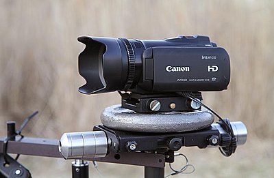

absolutely, plus the challenge will be not just for your wrist, but also for the merlin's gimbal, i tried couple times loaded with WA lens and mike EX1 on merlin, with additional weight it's doable, but it's heavy and i was getting a feeling that gimbal will snap any time;
Eric,
i shot that video with NEX5N on pilot, but there was a 5lb barbell weight on top of the mounting plate, my largest IDX battery and all pilot weights that i have to make the rig heavier, so it was looking close to this :)
HI Buba. So how heavy do you think your entire rig was? It looks like it was heavier than 6.5lbs...which is the weight of my Canon XF300...did you use the arm and vest?
