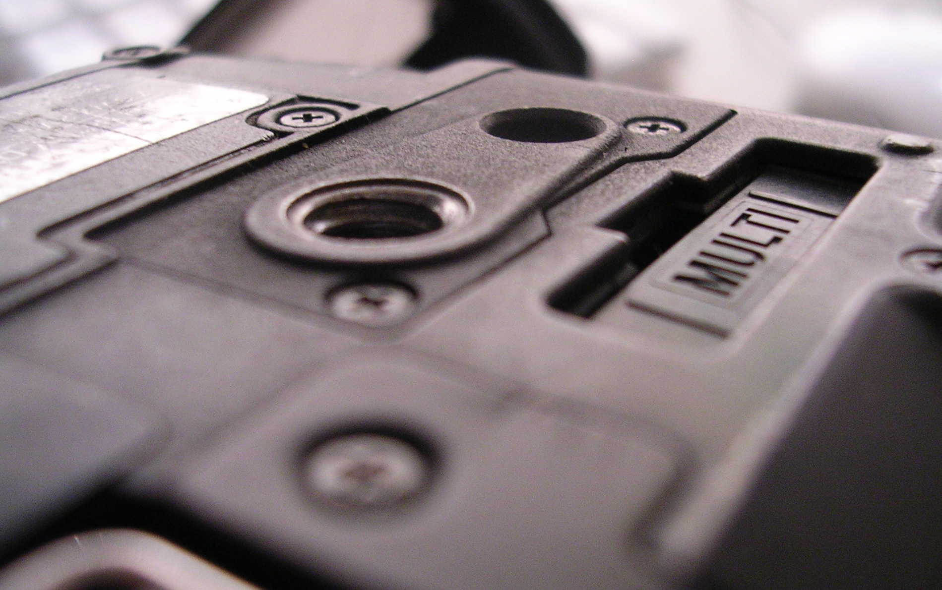

Old August 21st, 2006, 02:58 PM   #42
Location: Utrecht, Netherlands
Posts: 11
Originally Posted by Mikko Wilson
I'm not exactly sure what you mean here. Why do you need to roll the camera to one side? Is your camera's base not flat and level?
- Mikko
Exactly, the base is not flat neither level. Around the thread and the locating pin hole there is approx. 1 mm supporting area and beyond the surface is 0,5 mm lower. See attachment.
The Merlin manual is mentioning this - more or less- in Chapter 5 "Installing the Dovetail Plate, Prepare your camera": it is recommended to put some thick Gaffer's Tape running fore and aft (but I did'nt have it when I first set it up, maybe I should follow up the advice now..). With professional camera's this probably is not an issue.
Pieter

Old August 21st, 2006, 03:21 PM   #43
Join Date: Jul 2004
Location: Juneau, Alaska, USA
Posts: 632
Ew yeah, that's not good.
Yeah, tape or a peice of thick cardboard under there woudl definatly be a good idea.
Ugh, why do camera makes release shotty things like this?
- Mikko
