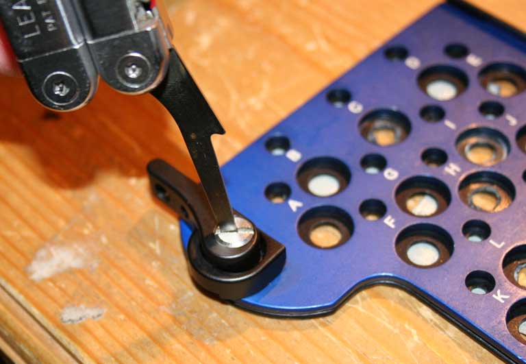

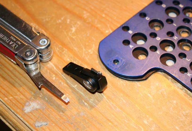

Hi
i need help!
the screw/clamp on the dovetail plate that you use to take the camera on and off the steadicam has come loose and come off. No matter what I do i cant get it back on. Could anyone help me please? If need be how could i get a new screw/clamp? i would rather not of course!!
thanks

Phil,
The dovetail clamp has prety short threads due to the thickness of the dovetail itself.
There should be a small nut embeded in the dovetail for the bolt to mate with.
Align all the parts of the clamp so that the flat side points inwards so that it will clamp onto the stage. Then carefully align the screw and give it another try. it Shoudl go in prety simply.
I don't have my Merlin on hand, but I will check when I get home tonight.
For now, here's a couple of pictures to show alignment...

thanks mikko.
i think somehow the thread on the screw itself has gone, that's why it isn't gripping

Phil,
You'd probabaly best contact Steadicam customer support (www.steadicam.com). It could be a waranty issue.
