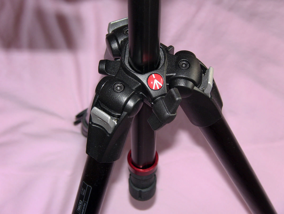

Sean, thanks for the reply. I can unscrew the level tightening screw/handle and remove the centre column, but there is no horizontal slot whatsoever.
I have attached a photo (apologies for the colour of the background in this impromptu shot) and unless I'm missing something really obvious, there's no way to mount the centre column horizontally.

So I finally spoke to a helpful chap at Bogen in the UK, who had forwarded my E-mail to Manfrotto.
Turns out to be an error in their catalogue, neither the 756XB nor the 756CX3 can do what it says about turning the centre column into a horizontal boom. It's not possible.
They thought the image at Video Direct wasn't entirely legit as they didn't have any tripod that fit the image and description. The closest thing they could come up with was a 190CXPRO3: tripods, heads, monopods, light stands, camera supports, lighting supports, professional tripod 190CXPRO3 - 190 MAG FIBER TRIPOD 3 SCT - with the suggestion being that the levelling function shown in the Video Direct image didn't belong.
Stuart Robinson is offline   Reply With Quote
