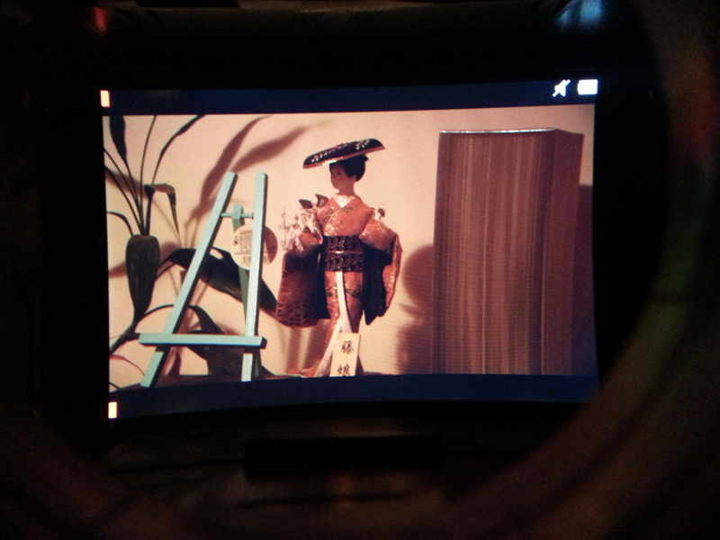

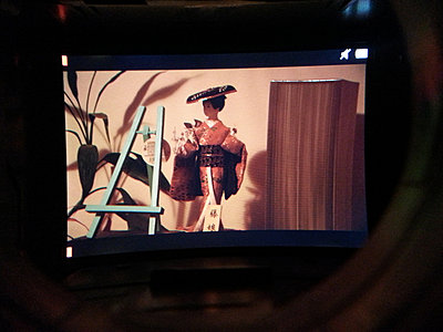

I finally received the EVF4RVW last night and briefly tried it out.
The screen seems high quality and enables a well focussed image I feel.
I was able to discern some pixel grain through the diopter but this seemed noticable more when I looked for it and when I focussed my eye on the display surface instead of on the image plane, though I could see pixels when looking at sharply focussed spots such as reflections on a chrome tube. Resolution seems high.
The diopter does not disort the image into a bloated or punked shape which was a concern I had and it is easy to see the whole scene without having to pan my eye too much which was another concern.
The photo below makes the view through the eyepiece seem punked but that is because the phone camera I used was 2" from the screen I guess. It doesn't look this way in reality.

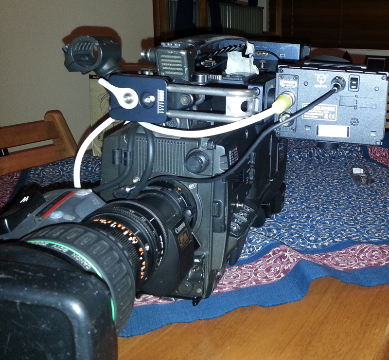

I have it rigged for shoulder mount and it works well this way.
