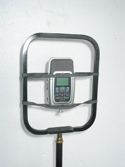

Filmed a wedding recently and shoved my H2 on a light stand about 3m up in the centre of the church to get audience singing recorded on it.
I forgot about people bumping the stand!!!! Grrrrhhh
So...thought I needed a shock mount for it and made one the other day. See photo.

I love it! Looks like an old style toaster for browning bread over an open fire.
Have you tried it out yet, or made any tests? It actually looks like it would work well.
