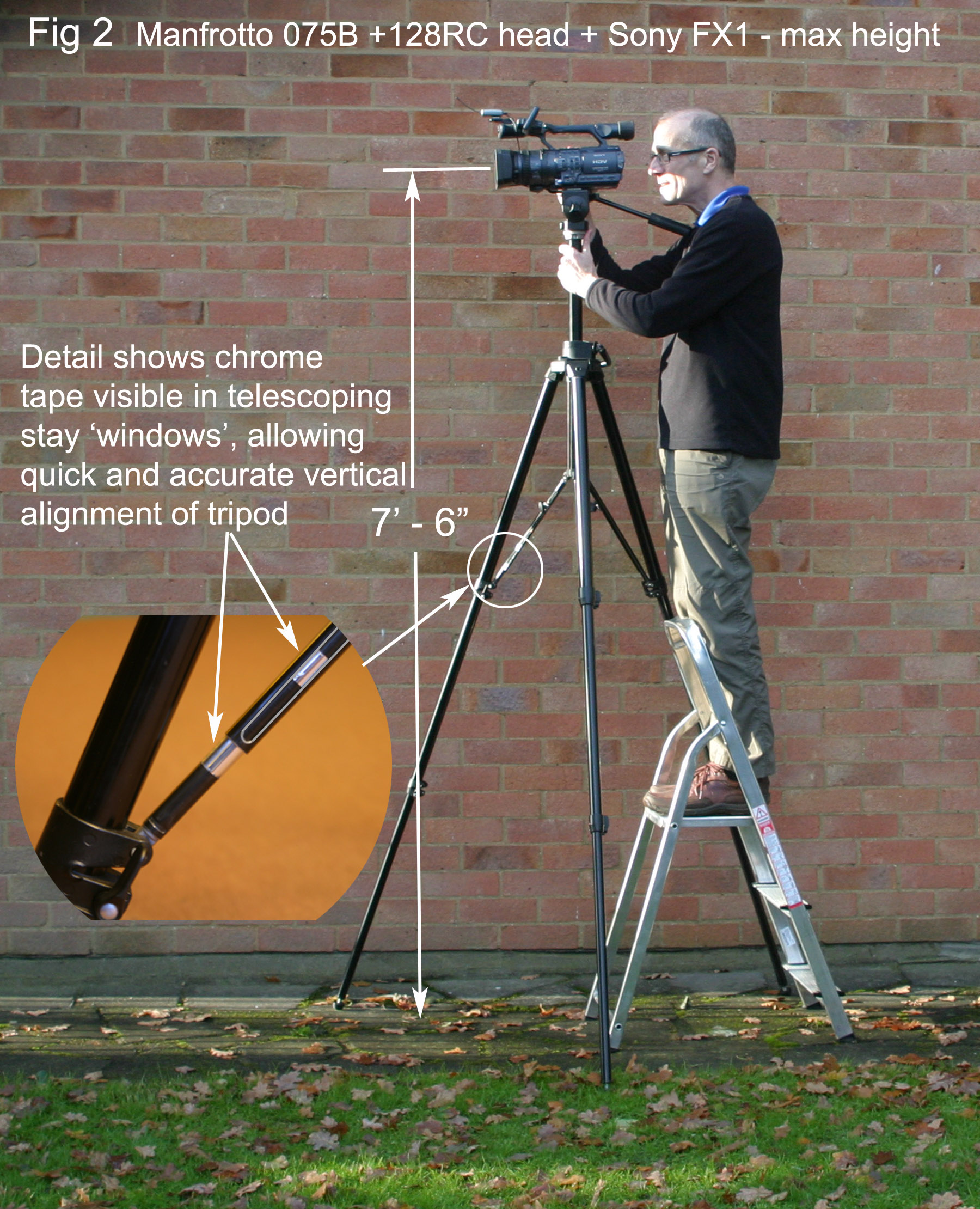

That's my answer too Gerald - use a tall tripod. Here's me showing how useful the Manfrotto 075B can be - as an unmanned tripod it sees above the heads of congregation, toasting guests and dancers. Yet it collapses small enough to easily fit into the car.
Tom, I just noticed something from your photo. Your head cannot level, and your tripod is leaning forward. If you pan left or right, your shots will be tilted. How do you level your camera?

I took another look at Tom's pic, if you look at the bricks, it appears the camera taking hte still was tilted... looks like the tripod shaft is pretty close to vertical when compared to the mortar seams. If the shaft is close to perpendicular, you can tilt the cam down and pan without it tilting.
Don't know about that specific tripod, but mine have these cheap bubble levels on them, and I'll usually try to reference a known vertical surface from a couple angles if I'm not sure or on uneven ground, gets me farily close.

Exactly right Dave. Warren - take another look at the photo and you'll see that your eye is being drawn by that middle tripod leg. The centre column is indeed vertical and the inbuilt spirit level on the Manfrotto is very easy to use. The markers on the centre stays (insert pic) means it's easy to level.
But as I say, generally this very tall tripod is used for my unmanned camera, so it shouldn't be off doing pans, it should be sitting still and be solid enough to stay there.
