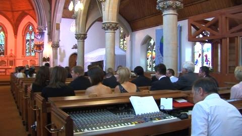

Posts: 416
Like this?
Martin at HeadSpin HD on Blu-ray
