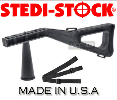

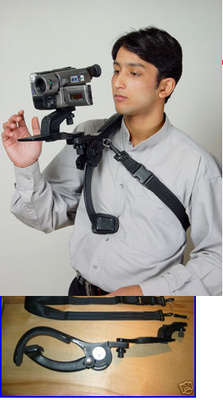

Hi guys,
what do you think of these cheapo ones?
are they ok you think for the 5D? I'm just worried that I won't be able to jam my eyes to the hoodloupe of the 5D with these things.
I'm just looking for something simple, light easy to put down and rig up. I've had a look at cinevate, red rock, zacuto and stuff.. beautiful babies.. but I can't afford to throw in another few thousand bucks on the rig at the moment.. plus I'm not shooting 5D exclusively just yet.
just looking for something cheap and nice to add in the goodie bag.
I think the most important thing is to have something that can rest on your body. that way you will reduce the shakyness. I've bought the hoodloupe from hoodman separately anyway, so I can sort of lean the camera into my eye somehow which adds stability.
The only problem now is whether these ebay items can put the camera close enough to my eye.
Please bear in mind that I've looked at some shoulder mount rig that rest the camera on your shoulder kinda thing. I think it won't really make a big difference to the stability. I think you'd need something around your chest area to be able to jam it against your body. but then again, i might be wrong.
Stedi-Stock Camcorder Shoulder Brace Stabilizer NEW USA - eBay, Other, Tripods Supports, Cameras Photo. (end time 12-Jul-09 07:24:54 AEST)
Camcorder Shoulder support/stand/stabilizer/FX1,GL1,GL2 - eBay, Tripods, Camcorder Accessories, Cameras Photo. (end time 13-Jul-09 14:15:01 AEST)
i'm attaching pictures in case the auction ends.
Santo
cheap stabilizer for hand held 5D-picture-6.png   cheap stabilizer for hand held 5D-picture-8.png

A couple observations, never tried the steadi-stock, but I'm familiar with the other design.
The steady stock is going to probably put the camera offset to your right - not a good plan, though I suppose you coud rig an offset bracket of some sort.
The other rig will work, it's very flexible with two diffrent risers which can swing in an arc - should be able to align with a little fiddling. BUT, be aware that if you're shooting video, that chest support will tend to "breathe" - it's actually far enough down towards your belly that it becomes hard not to transmit chest/belly movement. Otherwise it's a good rig.
Personally, I'd suggest taking a look at the tiffen Steady-stick (under $100) - I find that a belt support works better - the Steady Stick has a sort of shoulder extension, but it's articulated, so you can move things around as needed. Sunpak makes a compact monopod with a belt hook and lanyard that might help too - I've got a couple in my "support" collection, and they aren't bad.
I also have other compact monopods, a couple plastic clip on belt sockets the monopods drop in to, and a couple shoulder rigs which also can be attaced to the monopods... Primarily for small video cameras which really need the stabilization, but I've also experimented mounting a DSLR on the rigs as one of these days I hope for a Sony Alpha with video (a rep I spoke with said hang on a few more weeks... I hope he's right).
IMO, a belt support type setup is the best all around for cheap, and if you need more, some form of shoulder stock with TWO handles so you can control "roll" is about as good as it gets without going to a floating/gimballed rig.
With a DSLR you'd have one point of contact with the eyeloupe/hood, your hand provides a second contact point, adding a belt/upright support would provide a relatively stable third.
HTH's a bit.

I got one of these Steady Stock to play with. I wasn't very happy with my 5D2 and small lens (primes). Of course it can't support big zoom lenses. I find holding the camera stretched away from you with a nice padded neck strap to be more "steady" and comfortable. If you need support, than you may use a monopod for stationary shots, but the neck strap seems to work best when moving around with small lens.
Too much of shaky video with this steady stock.
As suggested I waist strap on which I can place the monopod, and neck strap would be fit best fit for support and moving shots.

Dave: I've actually got the steadystick. But I never liked it. I bought dv multirig and never looked back. It has now become my tripod replacement during ceremony. But I might try the steadystick with the 5d now. It might work because I'm not planning to pan a lot with the 5d.
ramesh: I've got lowepro belts that I've bought from B&H. you might wanna check it out.
I agree, I think steadistock wouldn't do a good job. I tried using the multirig with my 5D WITHOUT the stick. it was actually quiet heavy over time when you focus pull and stuff. I don't really get how zacuto rig can get away with the weight. Cause from what I have experienced, you would still need the stick with belt holster to be able to shoot conveniently.
