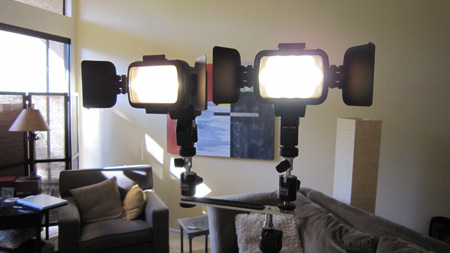

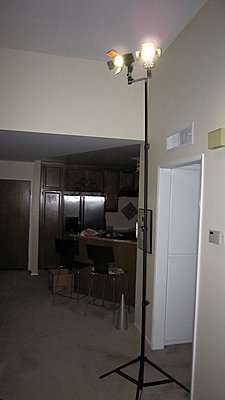

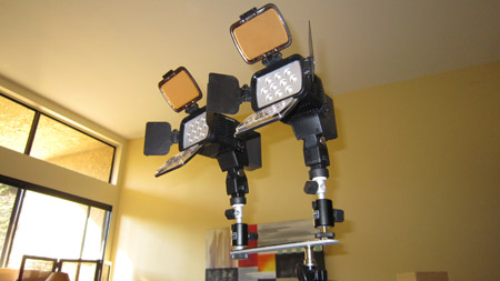

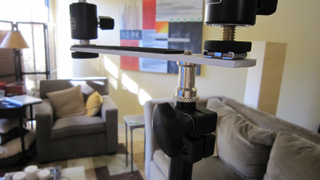

Finally I figure out a way to mount 2 lights on a light stand in an affordable way =)
Twin Lights On Stand | L.A. Color Blog
Light Stand and Dual Light Mount for Wedding Reception-twinstand1.jpg   Light Stand and Dual Light Mount for Wedding Reception-twinstand3.jpg
Light Stand and Dual Light Mount for Wedding Reception-twinstand4.jpg   Light Stand and Dual Light Mount for Wedding Reception-twinstand6.jpg

Looks good. Now you only should have a way to remote control it.

I have this setup yesterday at a reception. I am so glad I have such setup because the ball room is really dim. The DJ told me the customers want it intimate without much light. I ignored him. I have 4 comer lights all setup in spot light mode. It works very well. Here's the setup
Code:
                          [head table]                              [cake]
                                                 [two Comer lights]
                           [Dance Floor]
       [Cam B]               [Cam A]
When guests spoke, the two lights on stand creates a glow on them while the light on the camera lits their front evenly. Also, during the first dance and father-daughter dance, I circle them with my stedicam. The video looks awesome with the lens flare.
There isn't any light at the cake table. When they cut the cake, I turn around the twin lights to the cake table that creates a focal point (since it's dark everywhere else). After that, the bride and groom gave a speech there. The spotlight mode on the Comer lights work really well for that.
Consider the days before in such situation, I have to crank up the gain to 3db or 6db on my Canon XH-A1. Now I work in -3db and 0db only. The video is clean and grain free.
I will post some videos later on.
