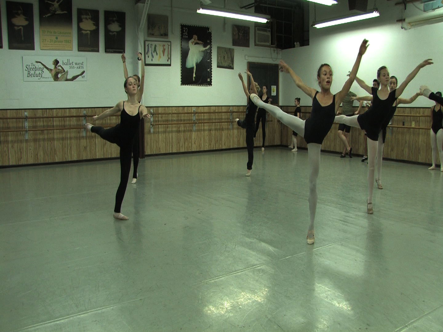

I'll be filming in a dance studio once a week, long-term. As of now, I'm currently just archiving the footage of each class, but there is hope to eventually extend it into a documentary.
In terms of lighting, the studio is well-lit by Fluorescent bulbs that are supposedly set to 5300k (although it seems a little less).
I'm just looking for some tips as to what's the best way to account for this lighting, adjust settings on the camera, etc. I'll be using a Canon XH-A1.
Also, any recommendations on which Custom Preset to use?
This is a new shoot for me so I wouldn't mind all the help I can. Any other tips would also be greatly appreciated.

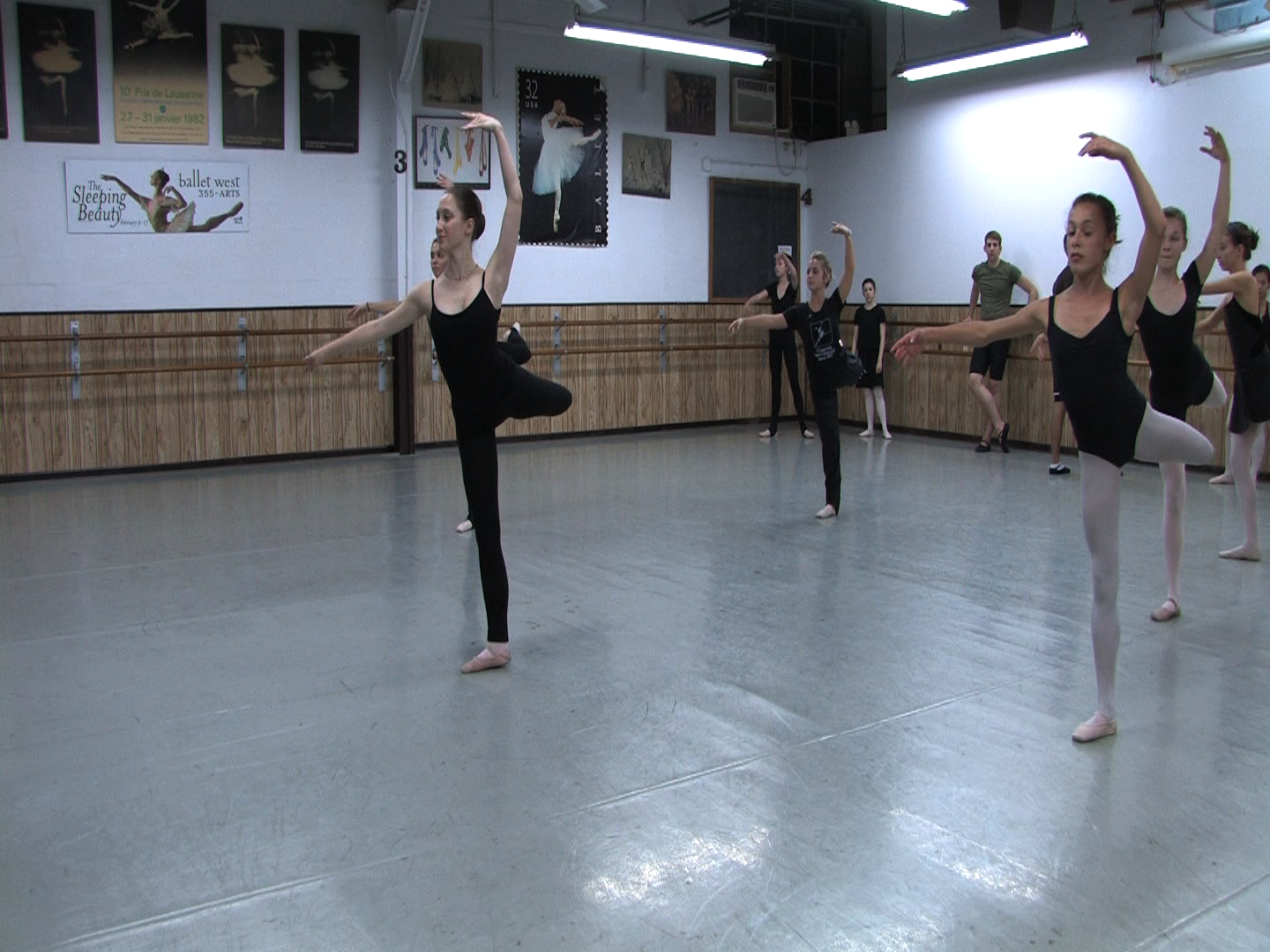

These are just some stills from the studio, I did during a test shoot.
The first, and whiter one, came from just hitting the white balance button.
The second being the one with the WB adjusted to 5300k.

I think both WB settings are good depending on the "mood" you want to achieve. Maybe ask the owner of the place which one he likes more. Manual WB looks very cold - I'd prefer the "warm" colors. Just you would need to remember that setting and do all the filming the same way.
I'm just thinking if there is any way to lit up the fronts of the dancers. The overhead lighting makes their faces "dark". Maybe set up some reflectors behind the camera to bounce back some light?

I recently shot a documentary with a Canon GL2 with mostly interior shots....and all were in different areas and lit differently. I manual white balanced and/or adjusted to depict the actual look of the room.
Your manual white balance, to me, looks far better than the gloomy-green second one (5300K setting). You might want to check your aperture/shutter settings as they also appear a little dark. I know that with dancing you have to watch your shutter speed though.
If this is footage might be used in a documentary later, I wouldn't go too crazy using artsy-cinematic presets...you might regret it later. You can always color-grade later in post if you choose. You might want to keep your raw footage clean and clear.

I agree,
The second image looks very green. The first image is a lot closer, maybe a bit too much blue.
This lighting is tough to get good looking skin as it trends towards green the more you move away from the blue look.
I would get a white card ($5 from B&H) put it in the lighting and use it for your white balance. You will probably need to work with the skin tones in post no matter what you do.
I also agree about adding light at a favorable angle to the dancers, but this can be distracting and might not fit the situation.
Be careful not to mix "well lit" with plenty of ambient light.
Think of your subjects.
The room has some light to work with but your subjects, the dancers do not have any light on their faces, mainly the only the tops of their heads. So they are not well lit.
If you expose for the dancers you will end up blowing out the rest of the highlights.
Also watch for mirrors. If they have some on the walls plan where you are going to shoot from so you do not end up in the frame.

Of course I realise that I'm making a judgement based on the colour of your photos on my comouter screen, but for me this is a no brainer; do your dancers have green skins? Is the floor of the studio green or grey?

In my opinion, you should go with the one on the left and then get the look you want in post.

I couldn't agree more.

I shot yesterday with the manual white balance, I adjusted it so it was a little less blue, and all went well. (I realized that both were very extreme on opposite ends of the spectrum; I think I found a good middle ground by zooming in on the wall and WB against that.)
