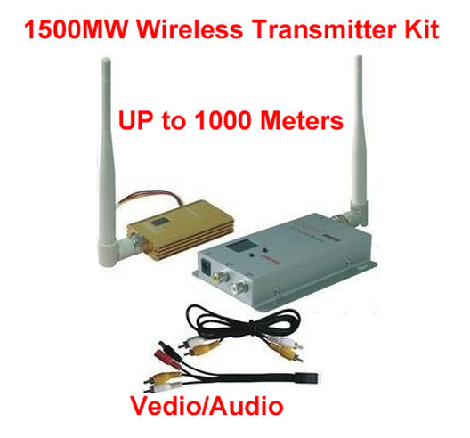

Come out of the NX5u via standard composite to the transmitter.
You will then be wireless on the camera side.
Something like - Transmitter/Receiver - eBay:
1500MW 1.5M Audio/Video AV Wireless Transmitter & Receiver kit,up to 1000M | eBay

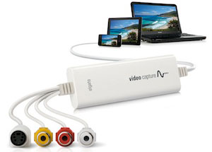

On the laptop side - connect the receiver to a USB Capture device - something like:
This will pick up the signal and send it out to the internet.
If you don't need wireless - just come out of the NX5u's Composite port straight into the USB Capture device.

I have a very similar wireless transmitter/receiver system from ebay....but it's black and white only! I use it for my teleprompter, so black and white is fine for me. Be careful, make sure it transmits in color before buying. I believe the set pictured above is for B/W CCTV security monitor systems.
