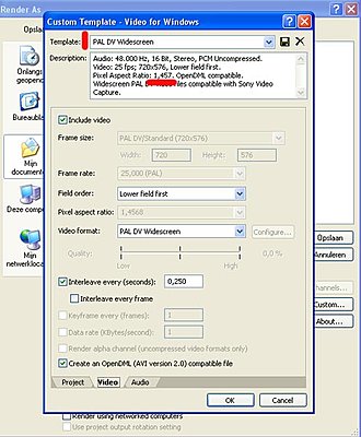

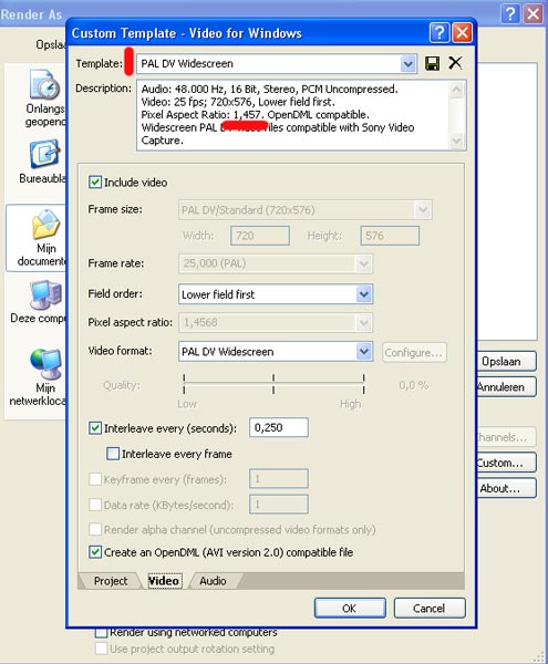

Try to render a piece with a PAR of 1,4568 if i remember correctly.

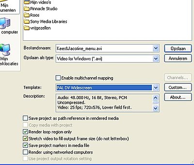

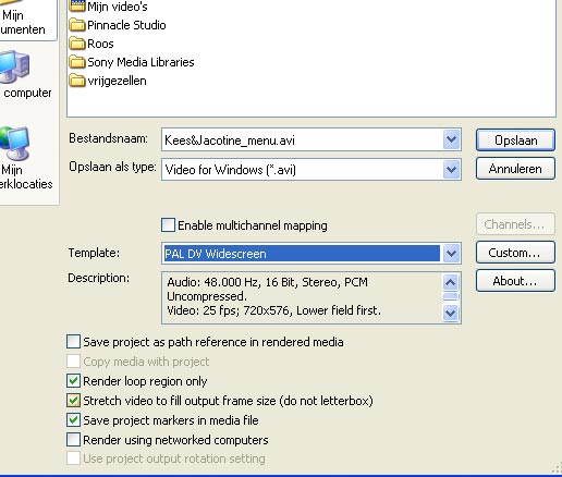

I did the suggestion above out of my head, as this setting has to be entered with rendering to 16:9 wmv.
So, i tried to render a piece from HDV to the PAL DV widescreen setting.
I was surprised i can't change the par with this setting, but it showed up correctly (1.457).
After that i played the file in mediaplayer and it showed up correctly, but when i tried the file in quicktime it showed up as a 4:3 file....
Strange but true. At least mediaplayer works for me.
W/Screen files playing as 4x3-paldvwidescr.jpg   W/Screen files playing as 4x3-par1457.jpg
